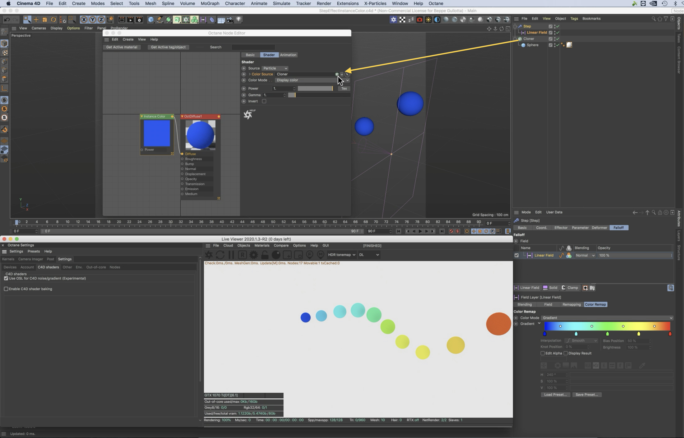

if you set your MoGraph cloner to Render or Multi Instance mode, you can use any kind of effector with Fields, and use an Instance Color node in your material, connected with the Cloner object: ciao Beppe
