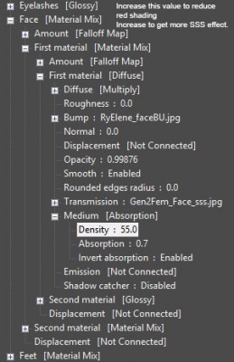

"That's because we tailored the skin shader to work with caucasian skin - you can easily fix this by increasing the "Scale" value in the "Medium" to a higher number - say 500-600 should do the trick for most dark skinned characters."
Could someone point me to where this setting actually is in the materials tree? Scale value in medium isn't showing up in where I'm looking.. Trying to get the red glow out of dark skinned models.. At a loss here.
Sure thing, are you on Poser or DAZ Studio ?

I am using Octane v3, Poser Game Dev.

Sorry for the delay in replying - was a busy week.
I attached a screenshot.
Was unaware that the medium "scale" was meanwhile renamed to "density" hence the confusion - sorry about that!
Let me know it this helped you.

Ahh and there we go! Many thanks.. It also works for reducing the red hands, nose and other nibbly bits from glowing red on pink characters as well.. Nice.
Looking good now!

Obviously my note on the top right corner of the graphic has a typo in it.
It is supposed to say "Increase to reduce the red shading on extremities" and "decrease for stronger SSS effect". Silly me...
