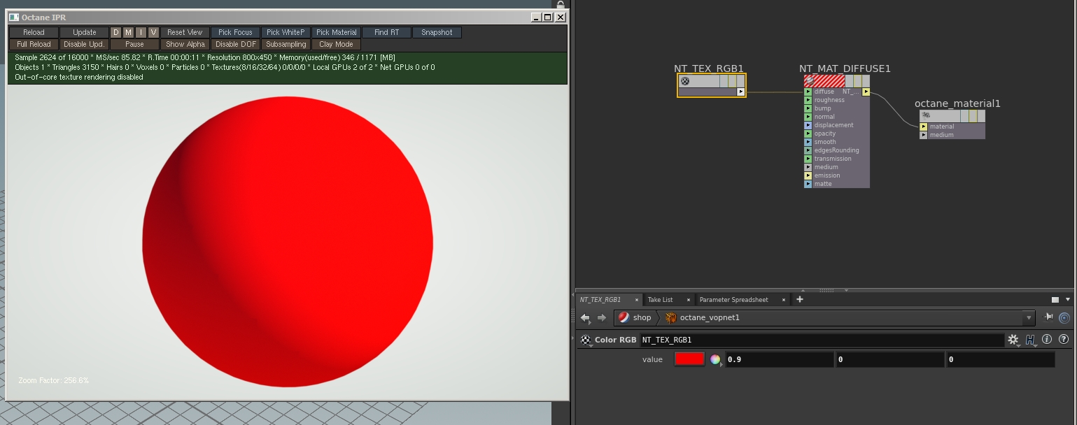

Thank you Juanjo. Unfortunately Houdini licenses are in high demand, and it would be too expensive to buy new ones with Octane plugins just for that purpose.
As for the bugs:
- Color RGB has wrong type of output (white) and doesn't work
- Emission BlackBody doesn't work in MediumVolume
- One I've mentioned elsewhere, but I think is very important - Rendering multiple ROPs Frame by Frame doesn't save any frames, while it seems to be rendering normally and doesn't give any warnings. it's the default mode, so it's very easy to make a mistake. I think this should be at least mentioned in the documentation. A warning would be better.

Thanks for the feedback about the plugin.
Yep, it is true that the RGB texture node output has a wrong type, probable due to a bug in the Octane API. I'll check it, but anyway the node should work, even with the error shown in the Octane node, as you can see in the attached image.
