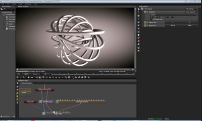

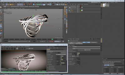

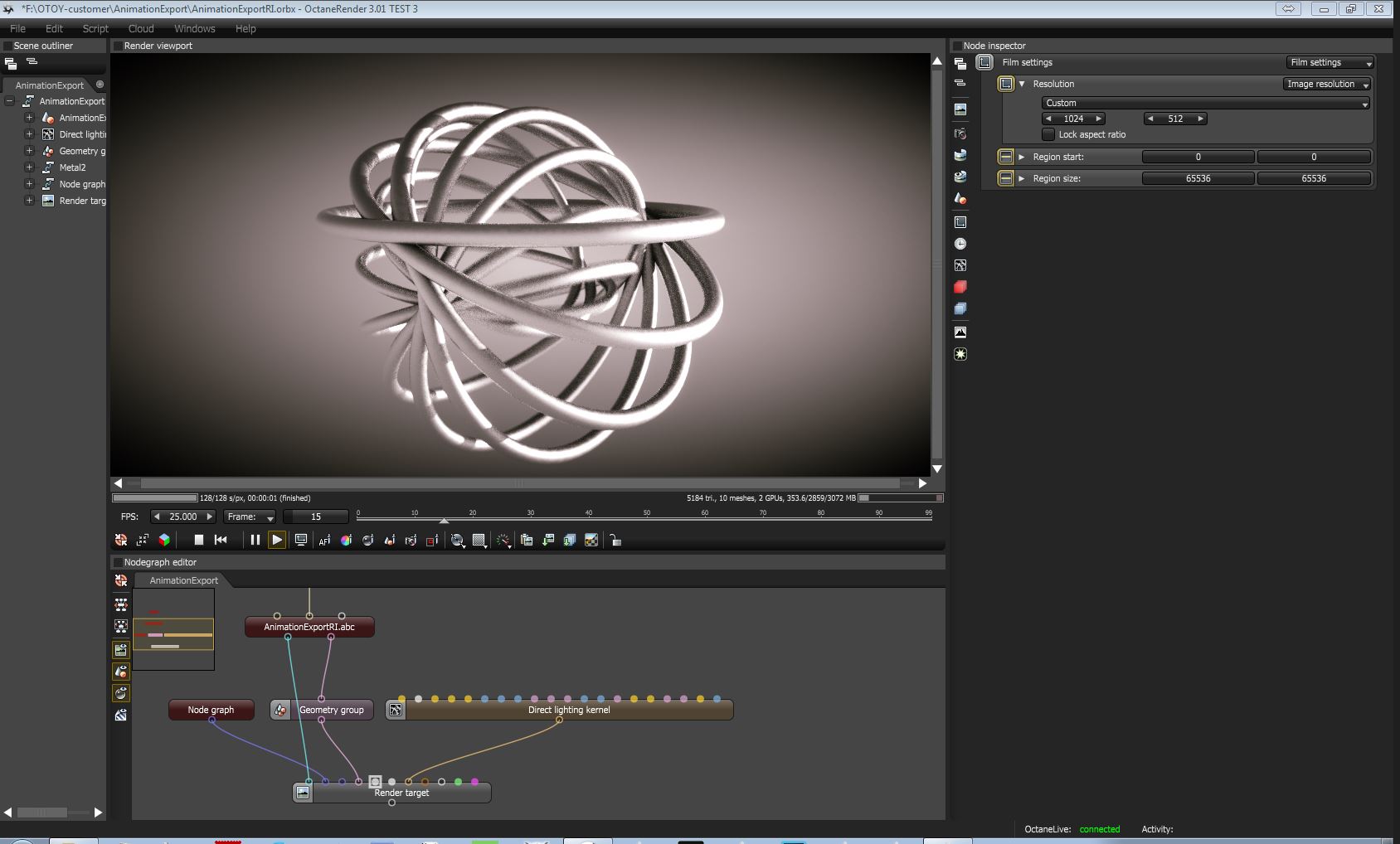

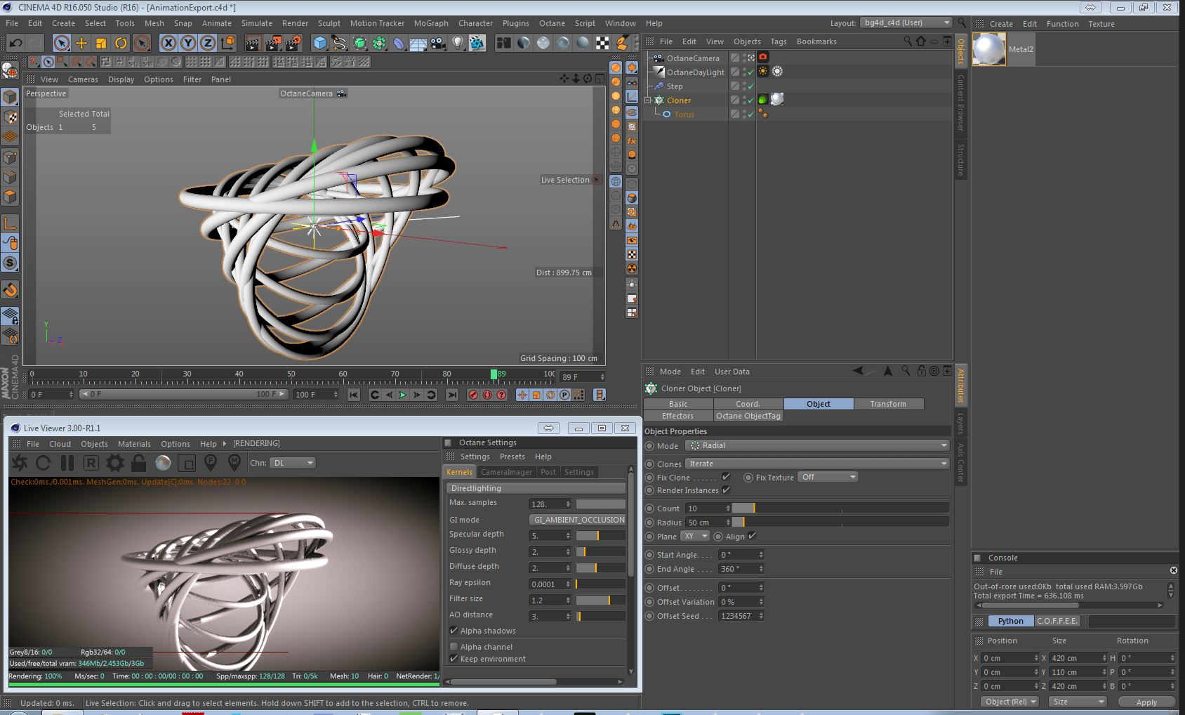

yes, just tried and with v3 there is no issue with or without render instance:
ciao beppe
