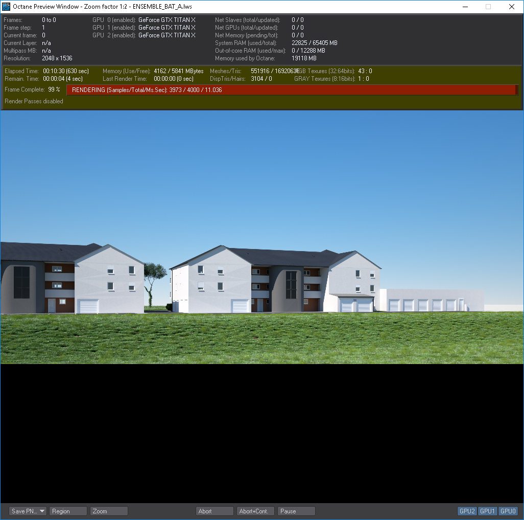

1 - Always a problem with instances that appear / disappear.
I have to close the layout, the modeler, the Hub and any reopening. On a big urgent project, it's painful.
2 - A problem who just appear, triangulations faces render visible ! And i've touch anything in modeler.
See attached.
Thanks in advance

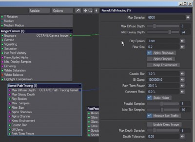

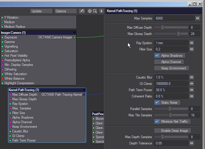

Set the Ray epsilon parameter to something bigger, like 1 mm for example.
-Juanjo
BorderLine
Posts: 294
Joined: Sun Mar 24, 2013 5:30 pm
Same problem with 1 mm. But i've an idea because i've normal map on this texture. If i sup normal map, it's OK !

Ah, yes, a wrong normal map can be also the problem. I am testing your scene here, but the instance rendering seems to work fine, I can't see them disappear.
Do you have this problem in the IPR or in the final F9/F10 rendering? When the instances disappear, can you see them in the viewports?
Could help if you enable the log file and send two logs to me, one when the instances are rendered fine and other when the instances are not rendered, to see what could be the difference.
-Juanjo

Yes, for instances problem, is'nt easy because it's time to time.
When i've the problem, it's in IPR and in F9 render.
When disappear, yes, i can see them in viewport.
Finaly, no problem for log files. I send you when problem happen.
