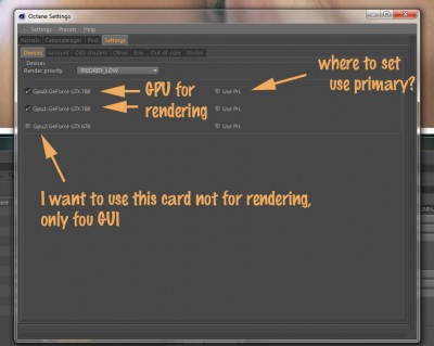

I am working with 2GPU x rendering and 1 (GTX670) dedicated to monitor.
I have setted "Prioirty LOW" and "Use Pri" on the first GPU as follow:
I have, expecially on heavvy scenes, some lags on viewport.

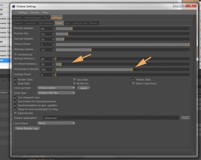

I've setted also in "Other" section as follow:
Should be possible to have too load with "Octane : Generate material xxxx" jobs?
In that case what do you suggest to set in "Options" window? Here my actual settings:

are you sure that you connected monitor to unselected card?

ah ah, Ahmet, you have really a bad imagine of me.. :D
Joking aside, no, this is the first thing that I have checked, the cables are correctly connected.
As the matter of fact is strange to have all this lags... my suspects is that they are related in some way to the material preview...often are present when the message "Octane:Octane : Generate material xxxx" is showed.

So i think this is different problem not about LV rendering, not about gpu activities. When a mat preview run on background it hold the main process. Can you test these scenes on latest Alpha? I think it's far better on any aspect.
