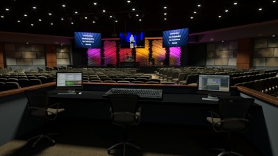

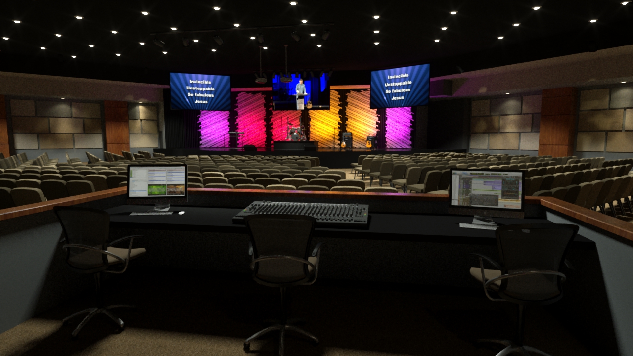

well it seems it doesn't crash...but the frames look quite a bit different. IES lights and quality are quite a bit different. will have to manage the crashes in .6 version for now...client has approved those images....
