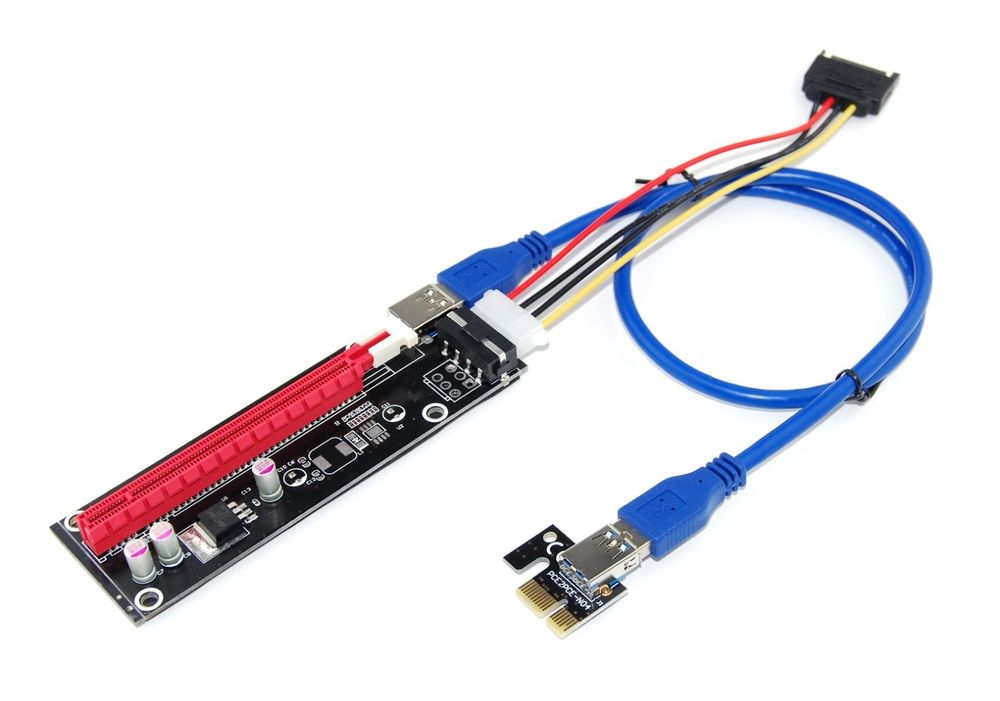

The rendering speed of PCI-E 1.1 X1 is 3.5 ~ 3.7MS / Sec
The Rendering speed of the PCI-E 2.0 X1 is 4 ~ 5MS / Sec
The rendering speed of PCI-E 3.0 X4 is 6.3 ~ 6.5MS / Sec
Rendering speed difference was much.
PCI-E 2.0 X1 Speed 3Way TitanX is 12~15MS/Sec
PCI-E 3.0 Direct Mainboard 3Way TitanX 18MS/Sec Over

Octane 3 has change the samples integration and frame buffers architecture, that is now done in the CPU RAM. This makes possible render large resolution images and a lot of passes without fill the GPU VRAM, but the problem is that there are a lot more traffic in the PCIe buses. The PCIe 1x buses are not fast enough, so a 10% to 30% performance hint has been reported while working with GPUs using low speed PCIe buses.

Yes PCI-E 1x extenders now are suffering rendertime in Octane 3.0.x.
Is there a way for DEVs to make checkmark for using GPU frame buffer instead CPU for storing frame buffer and passes?
"Use CPU Ram" could be as checkmark (like Textures are possible to swap to CPU RAM if necessary) That way we could have best of both worlds and turn on that system only if we need it (i often don't need to render Passes or too large image so if it fits in my 6GB or 12GB VRAM i don't need that new system so it would be great as option instead "mandatory" ?
