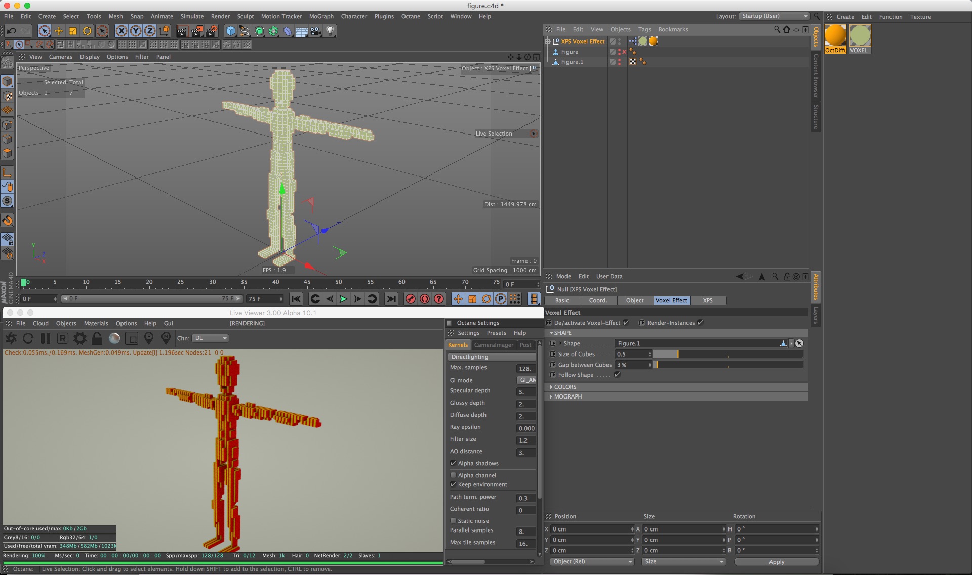

Hi Mike,
I have just tried with this setup and it seems to work well with Octane:
https://cgtools.com/voxel-effect/
It's free, it's not a plugin but an xpresso setup and you need to use an Octane material:
ciao beppe
