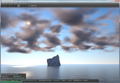

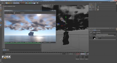

I have implemented VOLUME object since a few version back. I think not so much people is aware of the power of that. I suppose this is the way to go rather than pyrocluster things.
