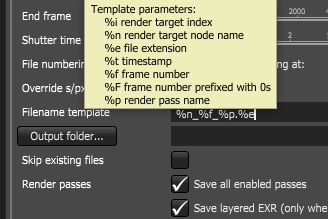

Octane for maya use the default filename template from Octane Standalone:
Except in Standalone we can change this dumb template.
Kai, if you read this Topic, a quick Fix for this major bug is to replace in the code the default filename template from "%n_%f_%p.%e" to "%n_%p_%f.%e".
(Hopefully this is not hard-coded in the SDK, if this is the case please tell me, I'll ask for a fix in standalone section)

I sum up the problem here :
When you render a composite EXR sequence "_passes" is added at the the end of the file name, between the frame number and the extension for example:
name_0001_passes.exr
But every sequence player or postpro software need to have the frame number at the end of the file name just before the extension to accept an image sequence, for example :
name_passes_0001.exr
By the way the problem is the same with the pass files from a non composite EXR, for example :
name_0001_diffuse.exr should be name_diffuse_0001.exr to be usable.
Cea suggest to supress the "_passes" suffix totally but not sure it's possible as it might also suppress the pass name for passes when you render non composite EXR wich is needed.
So I suggest to simply put the pass name before the frame number, not after. In Standalone template language this would be "%n_%p_%f.%e".
But if you think suppressing the pass name is a better solution, for non composite EXR, pass files should be written in a specific sub-folder, if not they will overwrite themselves as they will have the same name.

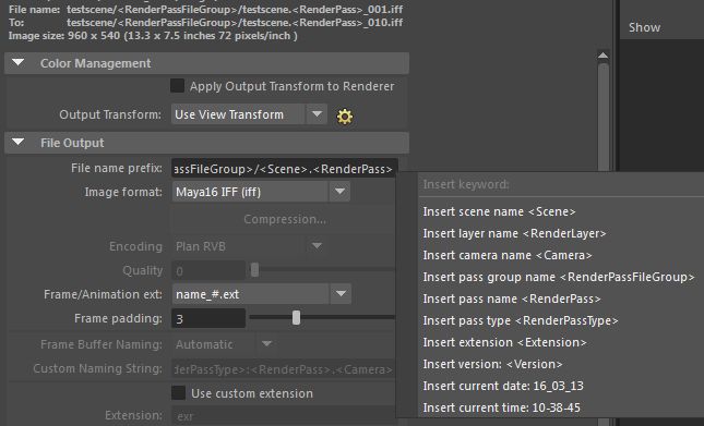

Don't know how familiar you are with "File name prefix" attribute in maya but I take the opportunity to push an idea about it which may be useful for later.
here is an example:
http://help.autodesk.com/view/MAYAUL/20 ... 599D4AE91E
this is really powerful and production proven, specially when dealing with thousands of images and tens of cameras, passes and maya render layers.
We can define here names and sub-folders, writing and using Maya Token keywords.
All render Token Keyword are not usefull/supported by octane. <renderPass> and <renderPassGroup> (maya software render specific), <renderPassType> (mental-ray specifique).
But maya API apparently allows to define custom Token keywords, we could define for example <PASS> which would give the octane pass name, e.g :
for myscene.mb "File name prefix" : <SCENE>/<PASS>/<SCENE>_<PASS> this would write every pass file for a non composite EXR in a sub-folder using the pass name, e.g : images/myscene/diffuse/myscene_diffuse.EXR
(again, not directly relative to our problem here but viewing this as a possible(or not) longer-term change may influence how you deal with our current issue)
