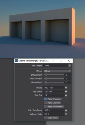

Let´s say I have a balcony with a ceiling on it. The balcony is pretty dark so I would like to add more light "bounces" to give a bit more light at the shadow areas.
I thought the diffuse depth would add more bounces and give some more light but I can´t really see much difference with diffuse depth 2 or diffuse depth 16.
Should the diffuse depth work in this case or how should I add more light to shadowed areas?

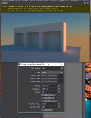

Might be the surfaces you have setup? Changing the bounces does affect the lighting in the scene as shown in this test. For the soft shadows you may want to adjust the SIZE of the sun, I think that will make it softer in places...
Also like you mentioned gamma and exposure will change how the final image looks. Your sample image looks to be blown out on the highlights...therefore showing more detail in the shadows....if it were not blown out on the highlights the shadows most likely would be darker and maybe not as nice looking ? Just some thoughts...

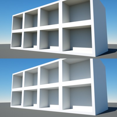

Here's a quick render test that confirms my suspicion: there's plenty of light to bounce around because you have a big patch of sunlight on the floor that bounces up nicely. Even with one bounce (diffuse depth 2, on top) you get plenty of light on ceiling and walls, and with three bounce (diffuse depth 4, bottom image) everything is very nicely and evenly lit. Surfaces are coloured RGB 200, 200, 200 (out of 255), so about 80% light redistribution, but you can definitely go lower and still have nice lighting on the ceiling.
I guess in your scene the amount of light that can be bounced up to walls and ceiling is just too small, due to the specific geometry you have.
Scene file attached. By the way, if you post your work in progress people will be able to help you out MUCH more.
