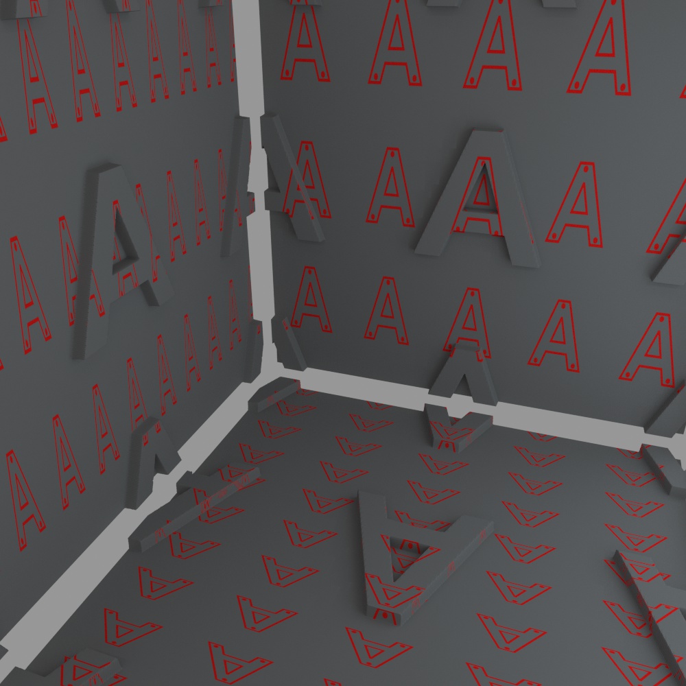

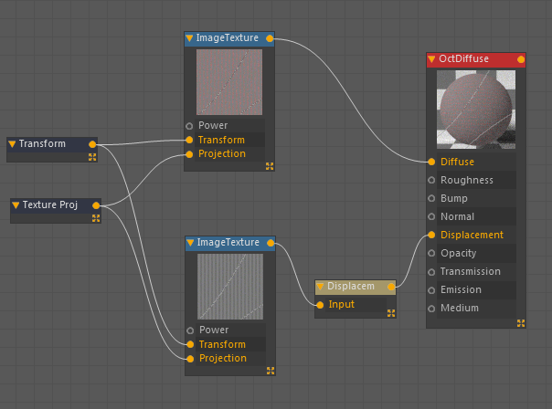

Good day, find a problem that cann`t solve: i loaded two images, one for color and the other for displacement, used transform and projection nodes but Color and Displacement don`t match
The material structure is very simple

I can use cinema 4d projection for perfect match, but maybe this can be done via octane tools?

It's not a bug. Just a limitation on displacement. Use meshUV rather than using box projection.
