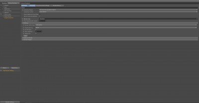

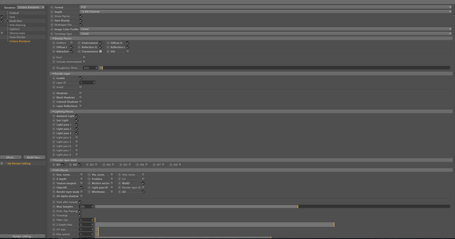

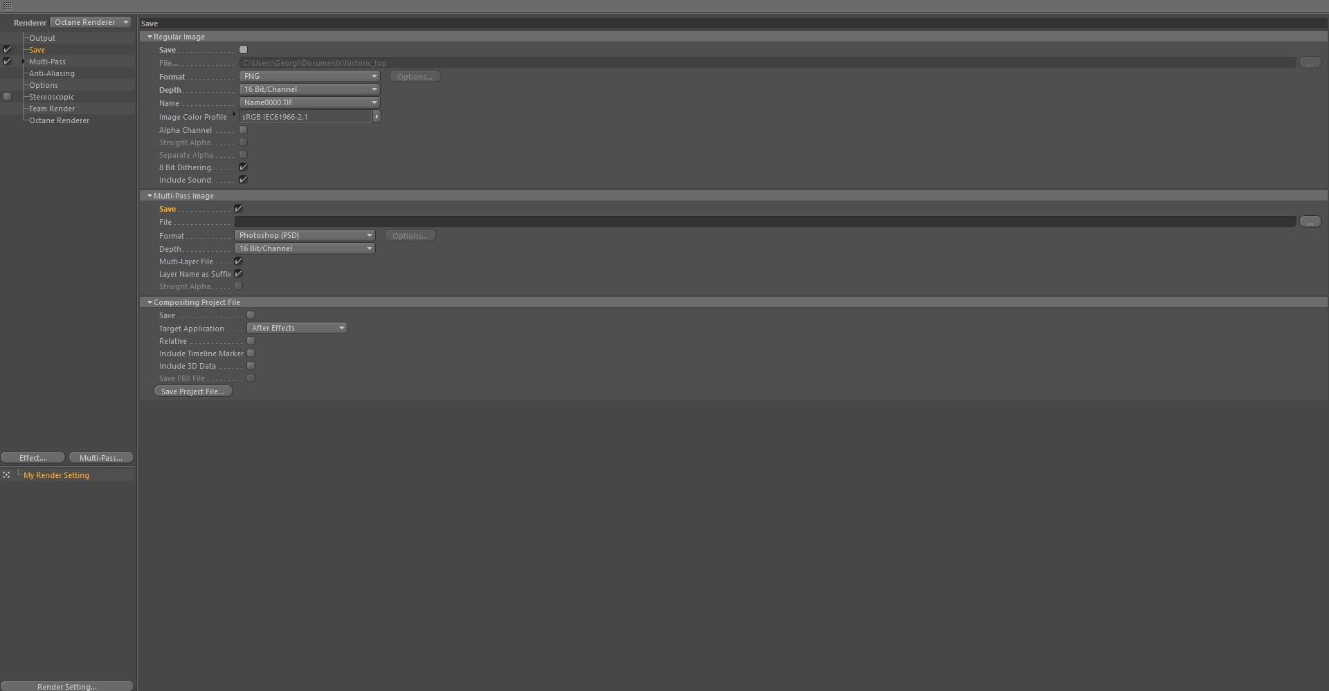

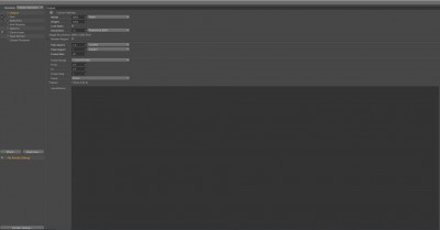

I have a issue when rendering a multi pass with Octane. I need to render a 8000 x 5000 px image and it is all rendering fine when I render just the beauty. But as soon as I enable the render passes, the render comes out black. Any ideas how to solve this issue? I have attached my render settings.
