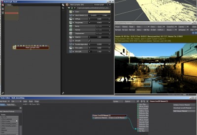

Is there a way to use Scripted Node orbx files in the plugin?
- gordonrobb
- Posts: 1247
- Joined: Sat Mar 16, 2013 9:08 am
Becuase it seems the only way to get accurate metals (with proper IORs) is to use a special script node that was created by OTOY. Other than that it's eyeballing, using a falloff node.
I think this is to use the script node Roeland made for metal materials with complex iOR in the standalone:juanjgon wrote:Nope, sorry. Why do you need this feature?gordonrobb wrote:Is there a way to use Scripted Node orbx files in the plugin?
-Juanjo
viewtopic.php?f=73&t=43973
Unlike the older global lua scripts, which only run in the SE, I believe scripted nodes are technically possible in the plug-ins( at least since 2.1 when they were added as a built-in type). I am not sure how they could be exposed in the host app UI, although in theory they could be treated no differently than a material macro from live DB.
How I can get this script? It seems encapsulated in the .orbx file and I can't get the code. The same material in theory should be possible using the available Octane nodes, without scripts.Goldorak wrote: Unlike the older global lua scripts, which only run in the SE, I believe scripted nodes are technically possible in the plug-ins( at least since 2.1 when they were added as a built-in type). I am not sure how they could be exposed in the host app UI, although in theory they could be treated no differently than a material macro from live DB.
It is not easy in LightWave support this kind of nodes with variable inputs, outputs, parameters and so on, but I will try to work on it for Octane 3.
-Juanjo
You can use the standalone to unpack it and see the lua script.juanjgon wrote:How I can get this script? It seems encapsulated in the .orbx file and I can't get the code. The same material in theory should be possible using the available Octane nodes, without scripts.Goldorak wrote: Unlike the older global lua scripts, which only run in the SE, I believe scripted nodes are technically possible in the plug-ins( at least since 2.1 when they were added as a built-in type). I am not sure how they could be exposed in the host app UI, although in theory they could be treated no differently than a material macro from live DB.
-Juanjo
Scripted nodes were an experimental feature in V2, but will be formally supported in V3 along with a script/module packager+validator for the node graph.
Ahhh, yes, sorry ... I didn't remember this feature in the Standalone
Try to emulate this script using the available nodes is going to be complex, so I will work in the support of the scripted graph node in the LightWave Octane 3 plugin.
-Juanjo
-Juanjo
