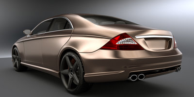

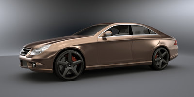

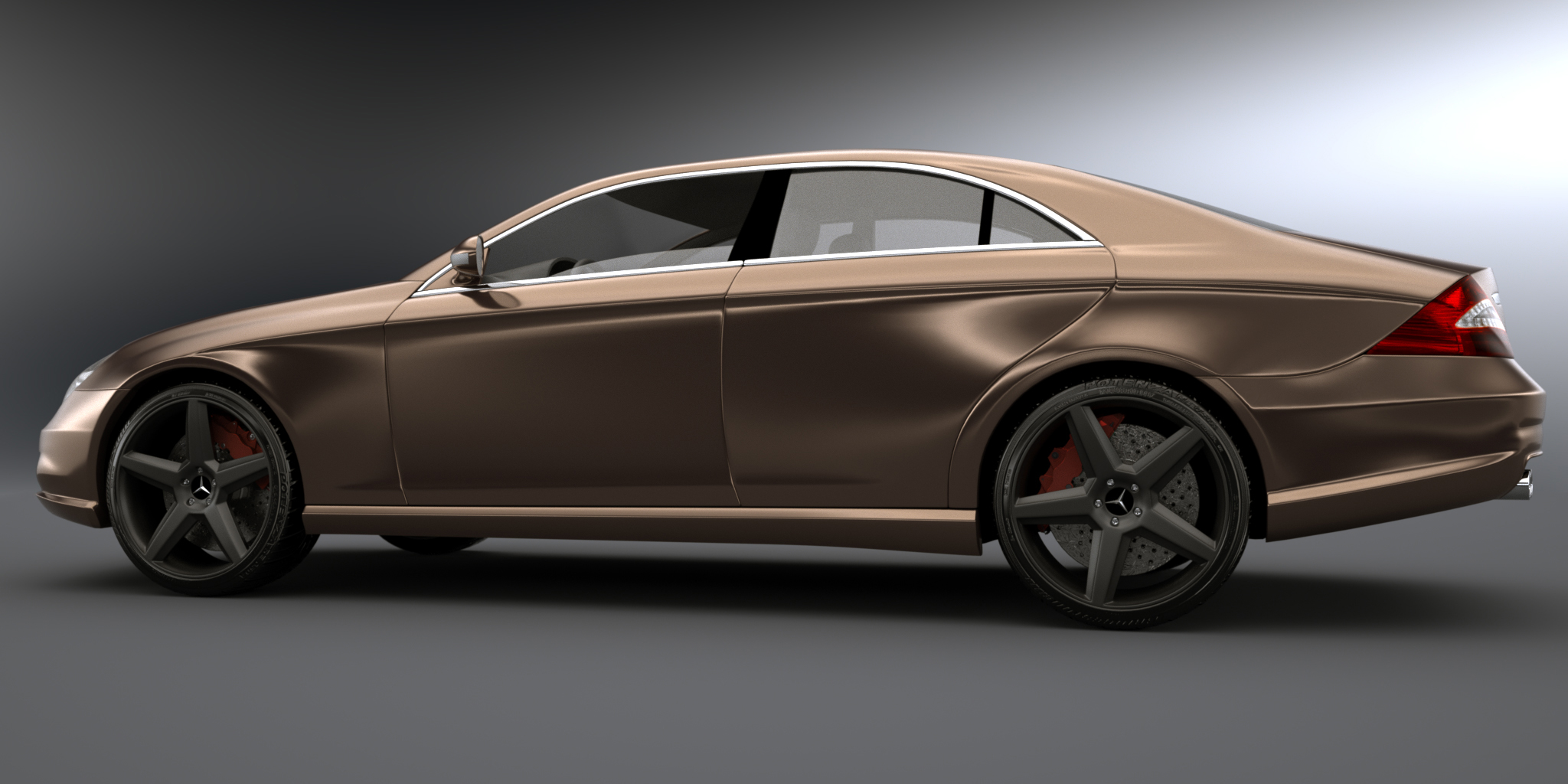

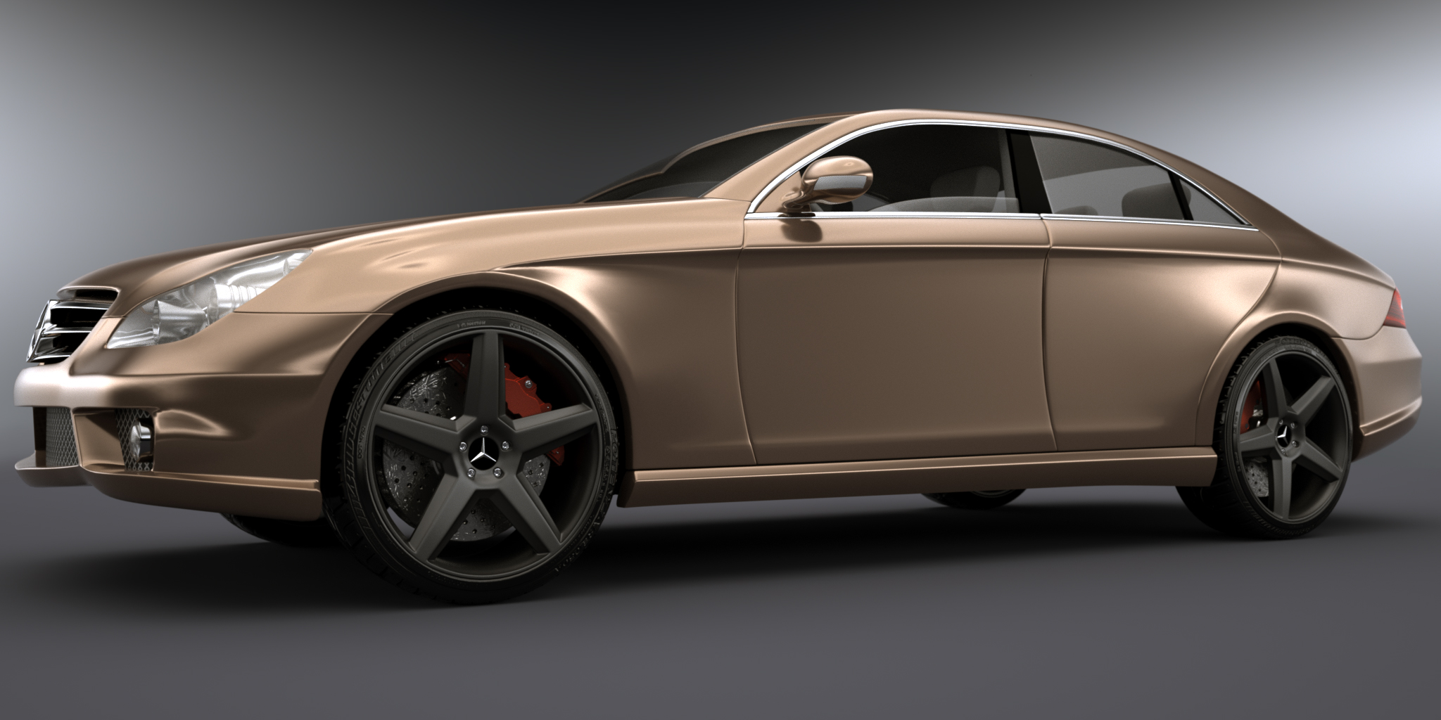

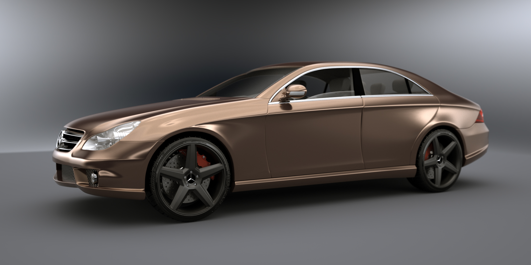

Here's something I've been working on. There's still a lot to be done on this model (its my model BTW.) but i had to quickly export this "bad boy" to Octane and do some test rendering :) I'll update this thread as i progress with the project. This might be an entry for the new year competition but i'm not sure if i'll be able to finish this on time.
Some specs:
Modeling done in Maya 2011
Tires and all the textures done in Zbrush 4.0
Rendering done in Octane 2.3 v5
Res 2048x1024, pathtracing, maxdepth 16, 2048 samples
Render time: images 01,02,03 around 6 min / image_04 8 min
No postprocessing - directly out of Octane
Thank you all for watching comments are welcome.
All the best,
Voja

Stunning! If you look at the door though there seems to be a problem. The shading looks like the door is not streamlined if that makes sense.

Skeletor wrote:Stunning! If you look at the door though there seems to be a problem. The shading looks like the door is not streamlined if that makes sense.
Thank you for your comment. This shader is overly reflective, almost chrome like, just used to check the surface quality. The car will look far more better than this, i've spent only 30 - 40 minutes on the render setup.

It's not the shader that concerns me it's the actual geometry which seems to be a little off at the doors edges

looks too aluminum. Maybe too much reflection blur.

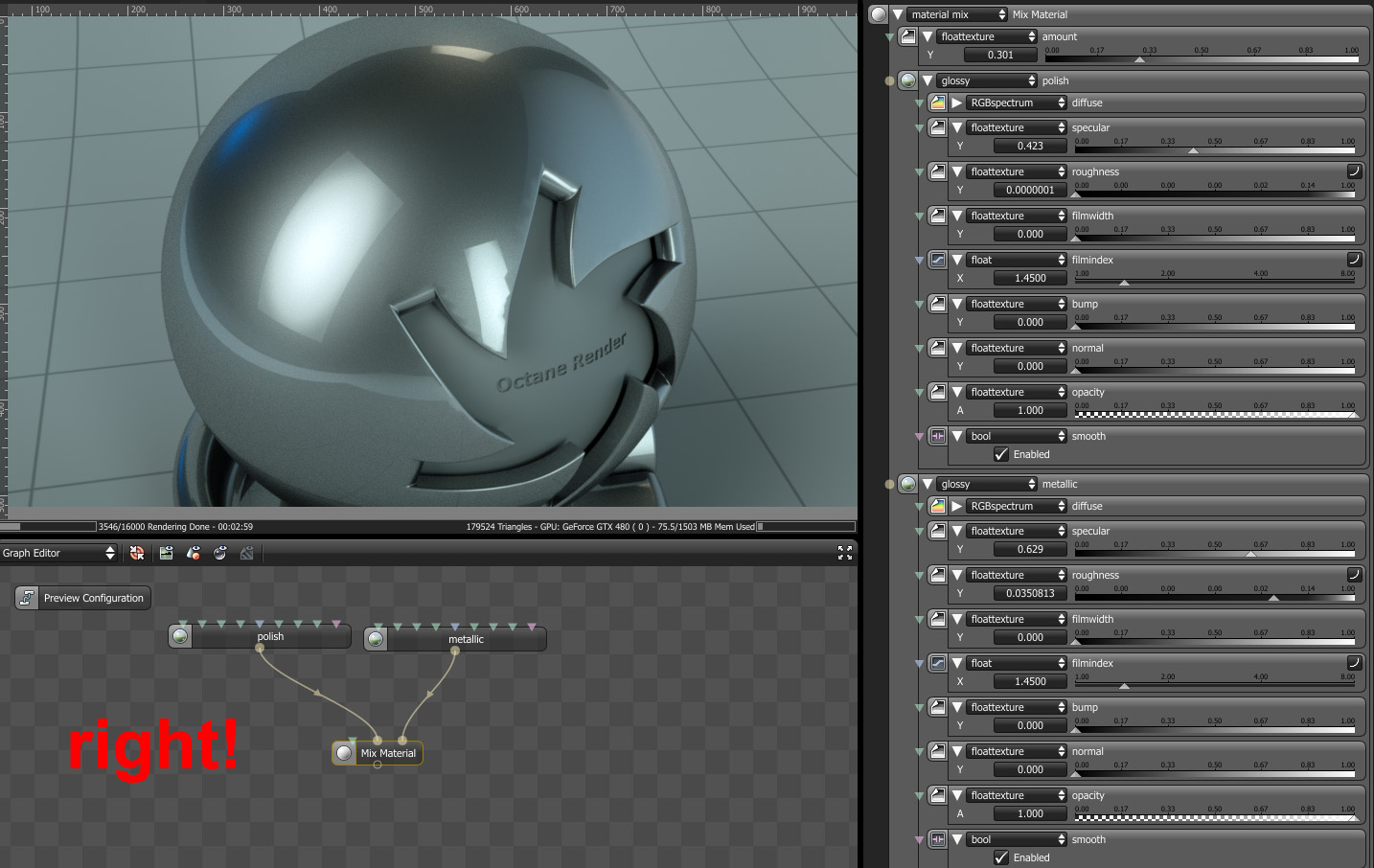

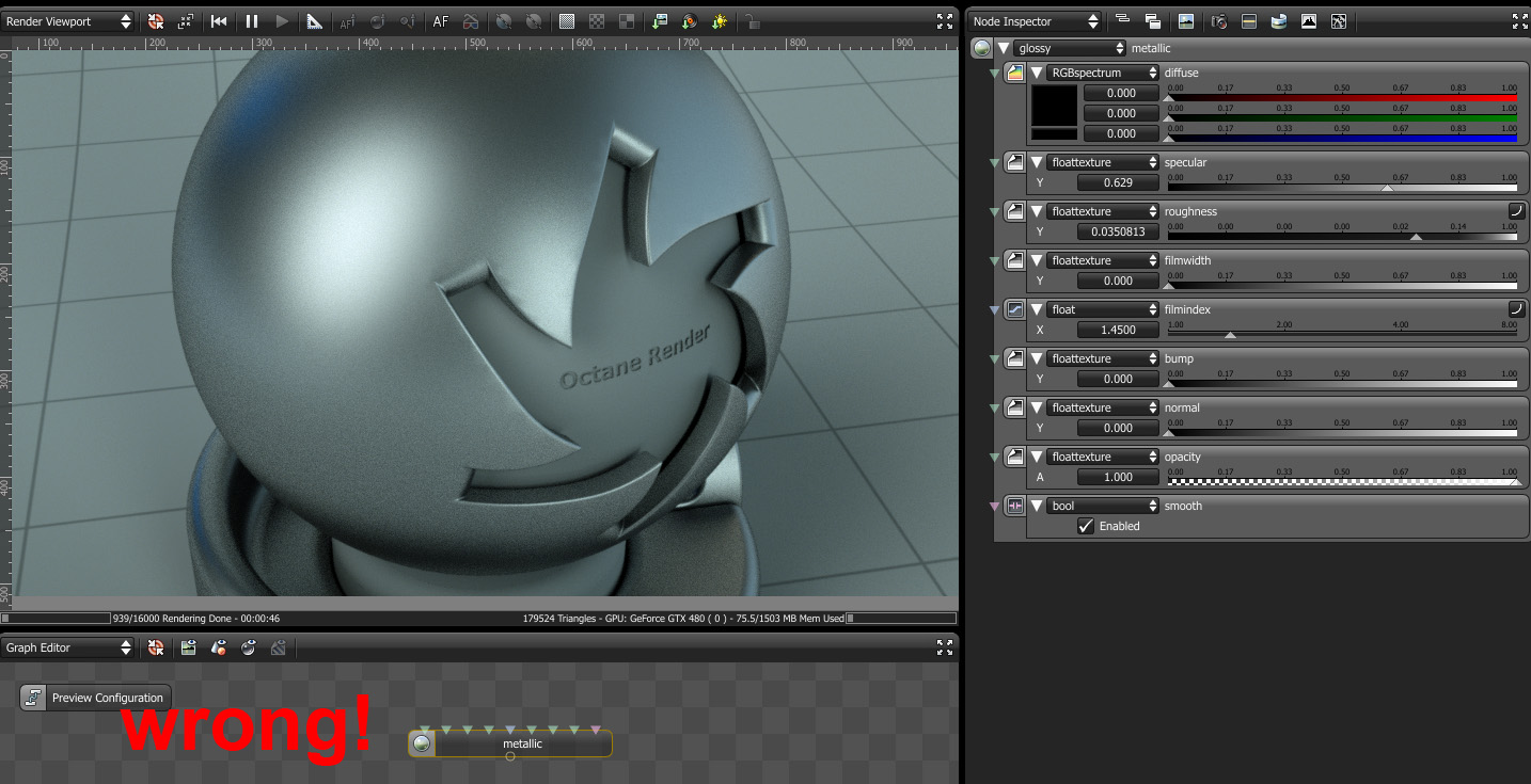

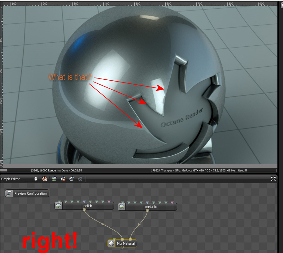

It doesn't look like a carpaint. That's because material has only one layer. Metallic carpaint contains at least two layers - metallic base and polish on top of it. In octane this can be done via mix of two material - one is glossy material with high roughness (metallic base), second is glossy too but with zero roughness (polish). Check two attached pictures. Mix material looks much more like carpaint than simple glossy material. In good carpaint shader you have to do some additional features - flakes for metallic layer (coz it's not uniform, it consists of tiny metal particles), some roughness and bump for polish layer (coz in real life polish isn't absolutely flat), but for medium and long shots mix material is ok. Good luck! :)

@rman1974: Thank you for your explanation. I want to ask what is wrong with the sample image. Is that affection to other edges too?

9fly wrote:@rman1974: Thank you for your explanation. I want to ask what is wrong with the sample image. Is that affection to other edges too?
That's a problem of the material ball geometry not of the material itself.
Thats called the terminator problem.
It´s a problem to calculate the right normals from two polygons.
