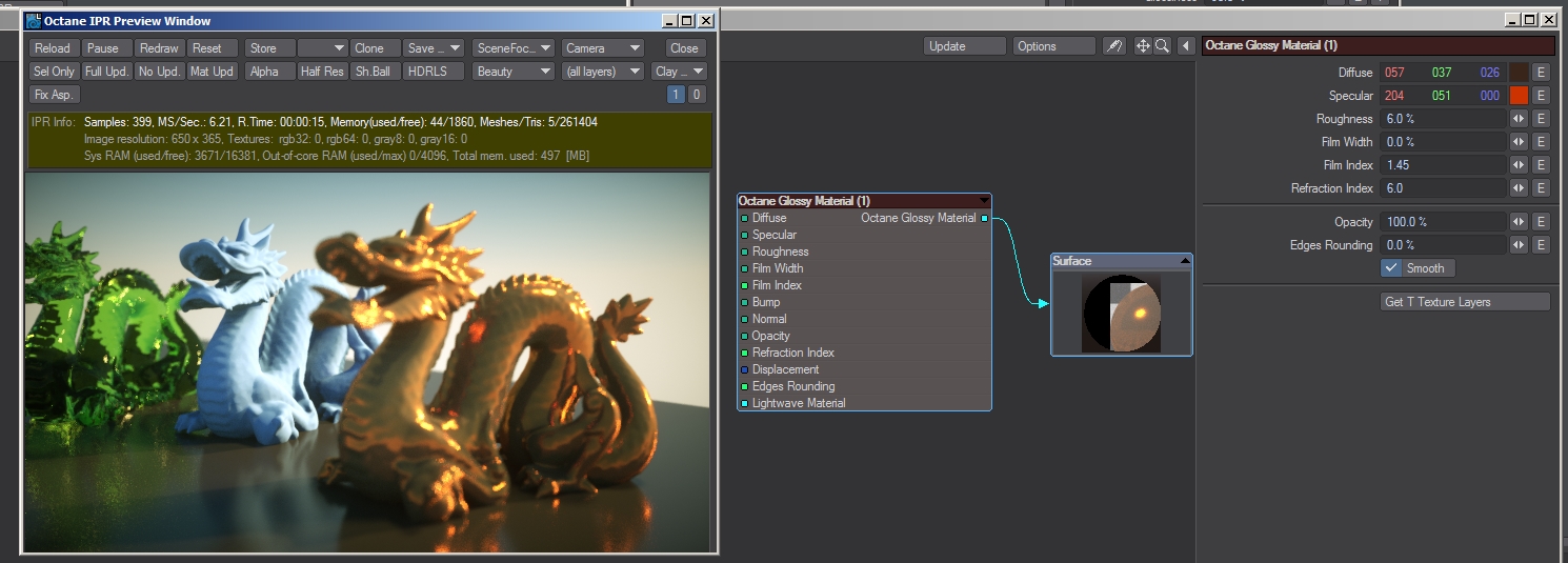

1. I have not been able to shade an object that would be strong color + strong reflections, like copper (http://homegardenvibes.com/wp-content/u ... 5_rwet.jpg).
When I try to shade the object, the reflection is good but the orange color is gone, or the color is good but the is no reflection.
See this one :
Do you guys have advices of how to do this? Is there a node for "boosting" up the diffuse color or something?

Octane is a physically based rendered. The materials have the energy conserving law, which means that reflection and diffusion are mutually exclusive. If you need strong colored reflections, your glossy material must have a low diffuse value. Also be aware about the refraction index parameter.

Thanks Juanjgon,
I didn´t realize I should use color on the reflection value. I thought that I should use only white-to-black values. That was the problem.
I got a better copper-material now.
