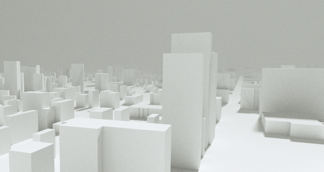

i need two things: a fog-enviroment and motionblur. both works separately without any problem but not together. in the attached (reduced)scenefile just enable the camera-motionlur in the cameratag and the fog disappers. is that a known limitation or an undiscovered bug?
i need both because of rolling wheels later in the animation, so post-motionblur in comp will not work. same for the fog-enviroment. its looks fantastic with octane and i cant reproduce the same look with depth-pass and compositing.

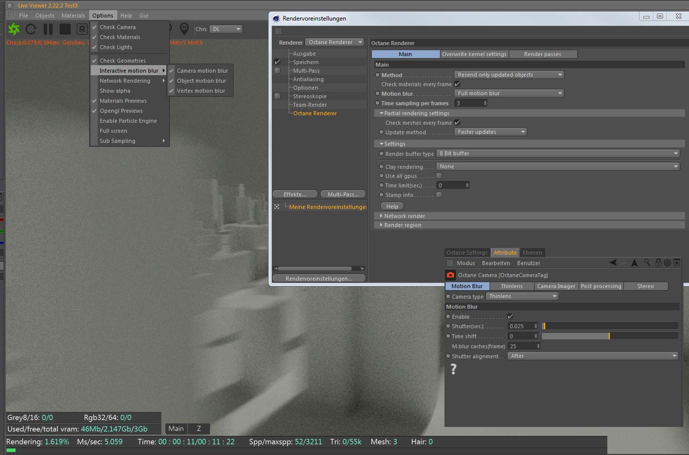

I had a look at your scene file and fiddled around a bit with some shuttersettings and time shift in motion blur and couldn`t get it to work either, until I got the simple solution: Just enable all motion blur settings in the live viewer and "Full motion blur" in the Octane Render Settings.
You had only Camera Motion Blur activated, thats not enough, when the "Fog Volume" is moving itself with the camera.
Here the edited scene file:

the main problem i found out is that the object-tag in my complete scene does not transfer the "fog-sphere" to sceneviewer properly when i move through the timeline and when i disable/enable motionblur in cameratag. then the "fog-sphere" is gone. "send scenedata" again and the fog-enviroment is back. :) so both works together right now.

ok, to drag the "fog-sphere into the camera is the problem. it works now without any trouble if i use a PWG-Constraint-Tag on the sphere, parented to the camera.

There seems a problem with proper refreshing on LV with motionblur. Also don't use "after" option for motion blur. "After" and "Centered" options cannot work properly due the logic of caching system while playing. Just can work on first sent.

Now I did some more testing with the settings I posted above, thats what I experienced:
1. Shutter alignment set to "before"
I can scrub through the timeline forward without any problems, but as soon I jump back some frames, the fog and motion blur is gone. Going backwards some frames more, it stays the same.
If I then go forward a frame or more after that, its fine again. No need to resend the scene.
2. Shutter alignment set to "after"
It is the opposite way: When going backwards through the timeline, everything is fine, but If i scoll some frames forward after that, fog and motion blur is gone. Going backwards again, and it is fine again.
3. Shutter alignment set to "centered"
Gives the described effect randomly in both directions.
As you said, the logic of the caching system is going forward in play direction, so using "Before" is the right one.

Logic is simple modes:
Before: register the key frames before the current time as shutter length
After: register the key frames after the current time as shutter length
Center: register the key frames before and after the current time as half of shutter length
When you hit send the scene to LV, you can see the exact output. That's the way to be sure.
