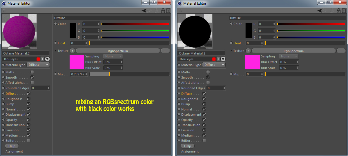

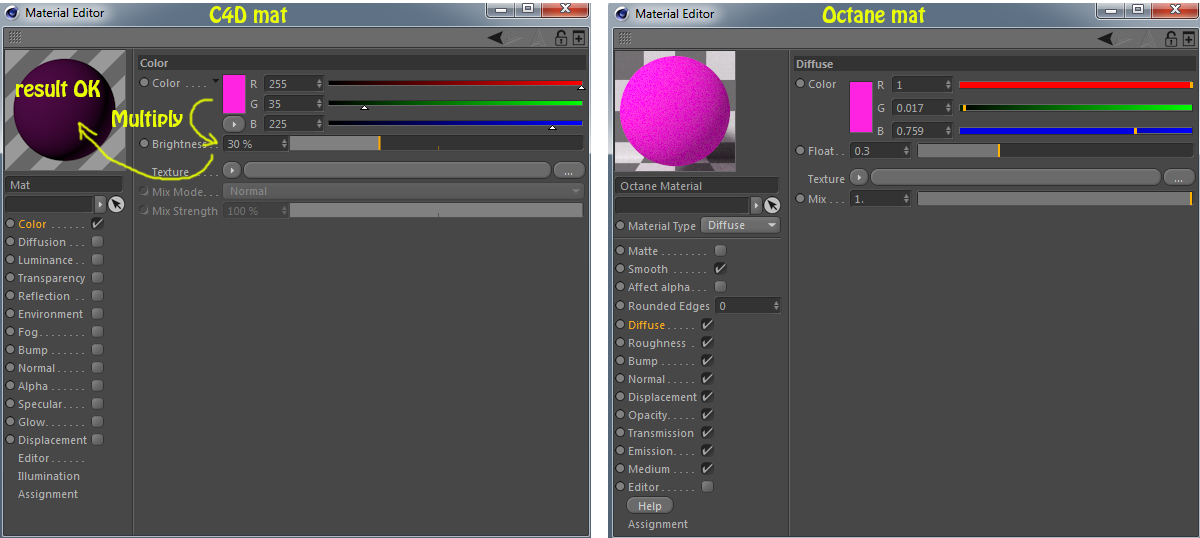

Other problem I faced are the float multipliers which doesn't work : here some screens
so for example the diffuse channel (or any other channels as it seems 'broken' everywhere ) the float mulitplier under the color choice , doesn't do anything . I think his goal is to multiply the chosen color and so allow us to blend between 0-1 to the color ? )
to turn arround this problem I use an RGBspectrum color and use the the mix slider to blend with a defaut black color ..not the faster way but it works .

It works. Color has a priority here. You should set it to black if you want to activate float sliders.clement wrote: Other problem I faced are the float multipliers which doesn't work : here some screens
so for example the diffuse channel (or any other channels as it seems 'broken' everywhere ) the float mulitplier under the color choice , doesn't do anything . I think his goal is to multiply the chosen color and so allow us to blend between 0-1 to the color ? ) to turn arround this problem I use an RGBspectrum color and use the the mix slider to blend with a defaut black color ..not the faster way but it works

hmm sorry I don't understand here , as you say the color has to be black to make the 'multiplier' slider works .. so we can't choose any other color so ? what is the goal of this color channel here so ? can't it just work by choosing any color and then use the float multiplier slider to blend it 0%-color chosen% ? if you compare to the c4d behavior : you choose any color and the 'float' ( strenght) slider blend it between 0%and 100% of the color chosen .. so I don't understand it doesn't work the same here .aoktar wrote:It works. Color has a priority here. You should set it to black if you want to activate float sliders.clement wrote: Other problem I faced are the float multipliers which doesn't work : here some screens

thanks for the vid Ahmet . No I can use texture + color , my question was for the float slider which doesn't affect the color except if the color is black . So I think it's not working correctly and the float slider should be a multiplier over the color channel ( so I choose any color and if the float slider is set to 0 , the result is black ..any inbetween values give a blend between black and the chosen color )
If I want to set a color and adjust his strengh , the only way is to not use the color channel but an RGBspectrum for example and make a mix between a black color in the color channel and the real one we'd like to have in the rgbspectrum .. the longest way to achieve a simple color strengh setup
As you show in your vid , you set a black color and when you adjust the float slider it becomes white ?? why ? there is something wrong here too I think . the color chosen should be at 100% floatvalue and anything lower than 100% should give a blend between black and the color .

ok, you want to use it as color multiplier. It's not designed for like that. It's a alternative to requirements for tweaking quick specular, opacity,etc.. Also too late, we can't change it anymore. Otherwise we will corrupt old scenes also someone may not want to have this.
You can use mix texture with a multiply texture for color intensity.
