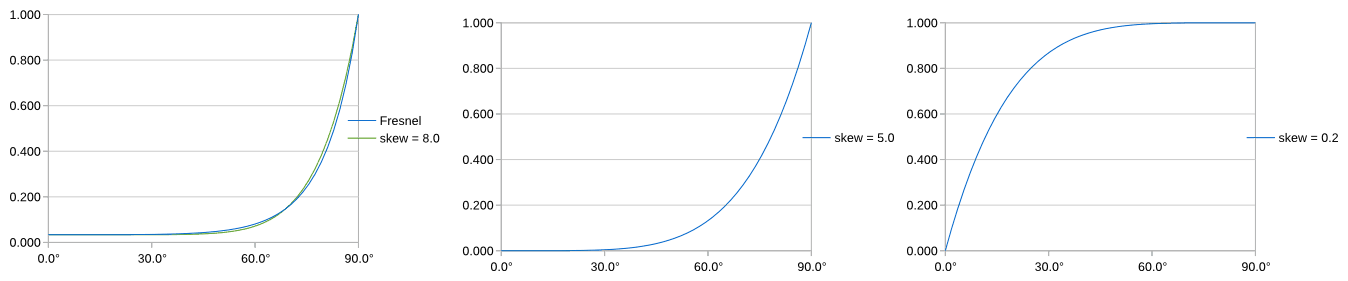

The falloff node works differently, it has a falloff skew factor:
If set to 1 then the value is proportional to the angle between the normal and the camera ray, i.e. if you look from 45° then the value is 0.5.
If larger than 1, then it applies a power curve to the angle.
If smaller than 1, then it inverts the skew factor, and mirrors the power curve.
You can approximate the behaviour of glass with skew factor of 8.0 and a normal value of 0.034.
what the falloff curves look like

Thanks roeland, that's exactly what I was looking for! That's not too far off from the numbers I was using when adjusting it visually.
It was said that all the documentation is being rewritten currently; I think it would be useful to put this info in there.
