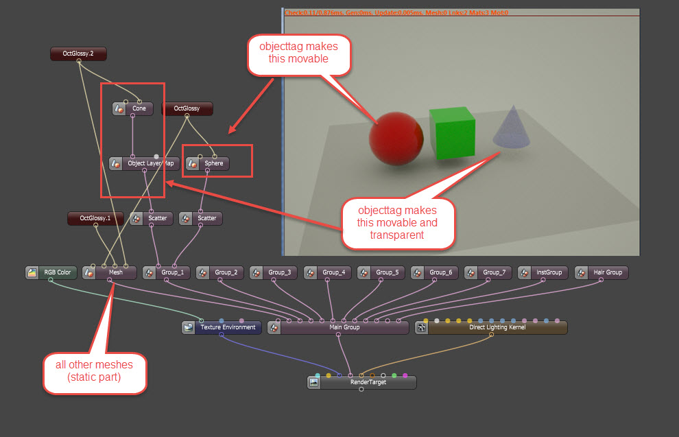

Hi, i have tryed to explain this several times on many topics, manuals. You should read object tag, animation rendering parts. But i'll try to explain quickly one more time.
Why we are using attaching object tags to make the objects movable?
Main reason is speed of geometry sending and compilation to gpu for renderer. This operation is much slower than any cpu based renderer. Can takes seconds or minutes on very complex scenes. We are trying to make this as low as possible.
Plugin will check the objects which have object tags. Also try to detect the types of changes. If change of object is a transform then will update only the matrices of objects to avoid refreshing the geometry data. Otherwise will resend all geometry data for current object to renderer. This will take much more time than a update on matrix.
Well, how to do this?
We are exporting this objects as single octane meshes. Each one goes to a indivual meshes to easily modify the related geometry datas without refreshing all other objects. What happens to other objects? I mean the object which have not any tag. All is collected to a single mesh.
you can see the exported structure in Octane node graph. See on Help->Show Octane node graph. It's just for debugging reasons but i'll keep it accesible to users for learning purposes.
see attached image also
Plugin will check only objects which has object tags. Also try to detect the types of changes. If changes is on transform then will update only matrices of objects to avoid refresh the geometry data. Otherwise will resend all geometry data for current object to renderer. This will take much more time than a update on matrix.
