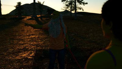

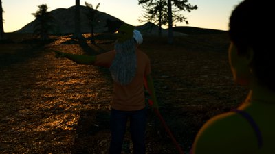

I’ve been having trouble with the new hair feature. I find that it often crashes Layout. I’ve been working to determine when and why. Sometimes the crash occurs after I add an mdd in “ClothFX” and then try to render.
I have observed that my system memory surges while “UPDATING SCENE IN GPUs…” as I add more hair to my character. It hits 96% (of 32 GB) making the system very slow. Then it drops again towards the end of this process. This can take ten to twenty minutes. And rendering becomes considerably slower.

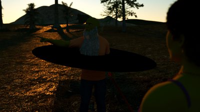

Finally, I find that a strange black circle sometimes appears.
I’ve had to temporarily turn off sub-surface scattering in the characters’ skin (which is a false color in the images I’m uploading), and also turn off instancing, in order to test the hair. There is normally grass and also lots of trees.
I’ve tested in both Mac and Windows. Windows generally does not crash as often. Mac always crashes when I try to use IPR with hair. (This is on the same dual-booting computer.)

PS - But what's that weird black circle????
