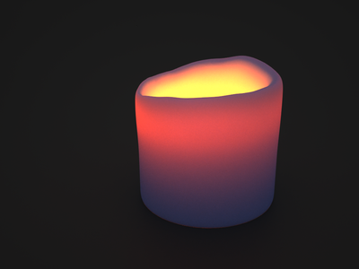

atnreg
Posts: 230
Joined: Thu Aug 21, 2014 5:59 am
Location: Helsinki, Finland
Now I slowly start to get it, I loaded the dragon_sss scene and started changing the values, that way I slowly noticed which affects what. And now I even managed to get my candle test to work, some strange things still with colors but it's getting closer :)
Of course the flame is still missing, now the light source is the candle-snuff which of course is totally wrong but from this angle it is not that bad :)
The candle object was modeled in ZBrush, then layout made in Lightwave and rendered with this excellent Octane plugin :)
Scale=80m(!!), Phase=1.0, Scattering=0.23
