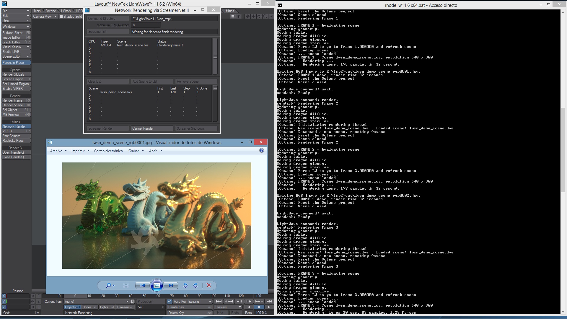

juanjgon
Posts: 8867
Location: Spain
Yes, the demo version can be used without problems to test the LWSN rendering. You only need to create a "octane_node.cfg" file in any root directory of your render node with a dummy license data, something like:
"xxxxxx"
"yyyyy"
Please, test it and let me know if it works for you.
-Juanjo
