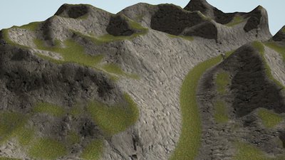

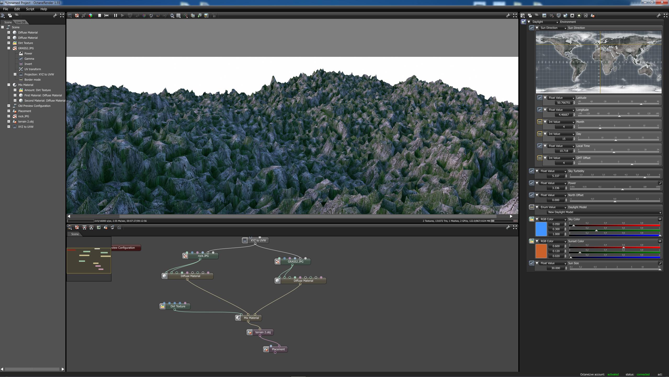

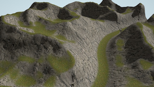

Jaberwocky
Posts: 976
Joined: Tue Sep 07, 2010 3:03 pm
I tried a dirt to mix grass and rock on a rocky landscape.Ended up with this.
The mesh was a fractal generated in meshlab and saved as an obj file.Uv and materials were applied directly in Octane Stand alone.
One thing I've found is that the standard daylight system lighting is far to harsh, so i set the sun size to 30 , the turbidity to high and compensated by increasing the sun power up past 1. The shadows and the daylight are not so harsh now.
