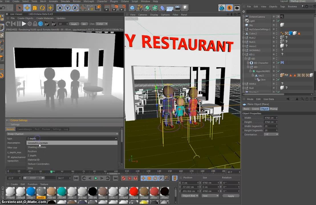

After looking at the video again I think it is octane renderer with some buffers already working in c4d. So that means its working already in standalone? I don't really use standalone so I don't know.
This means lwoctane is a bit behind the c4doctane.
materialid, zdepth, etc can be clearly seen in the dropdown.

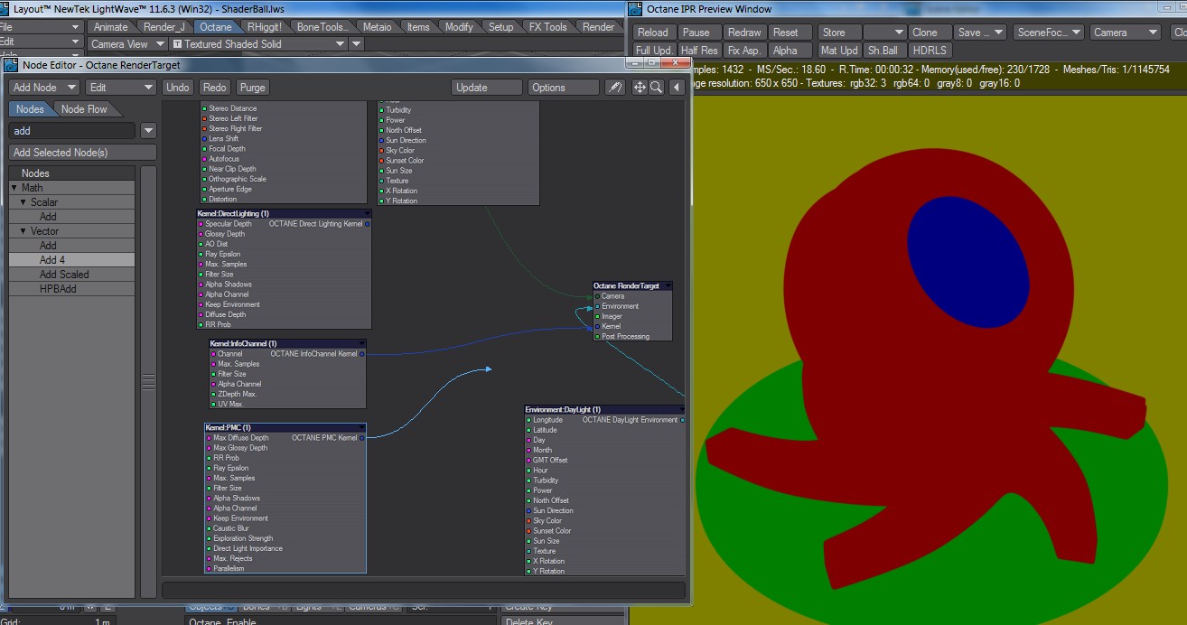

Looks like we have it. Its done via Info Channels Kernel.
http://render.otoy.com/manuals/Lightwave3D/?page_id=166
Dont think there's a sample file yet for this.

Juanjo, how can we render all the buffers on the infochannel in one render pass together with the beauty pass embedded in an exr? Tried some nodes to add them but nothing.
Lewis
Posts: 1101
Joined: Tue Feb 05, 2013 6:30 pm
Location: Croatia
We can't sadly, no way to render them all at once, you need to setup/render them separately :(.
I guess we need to wait for Octane to include AOVs
