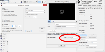

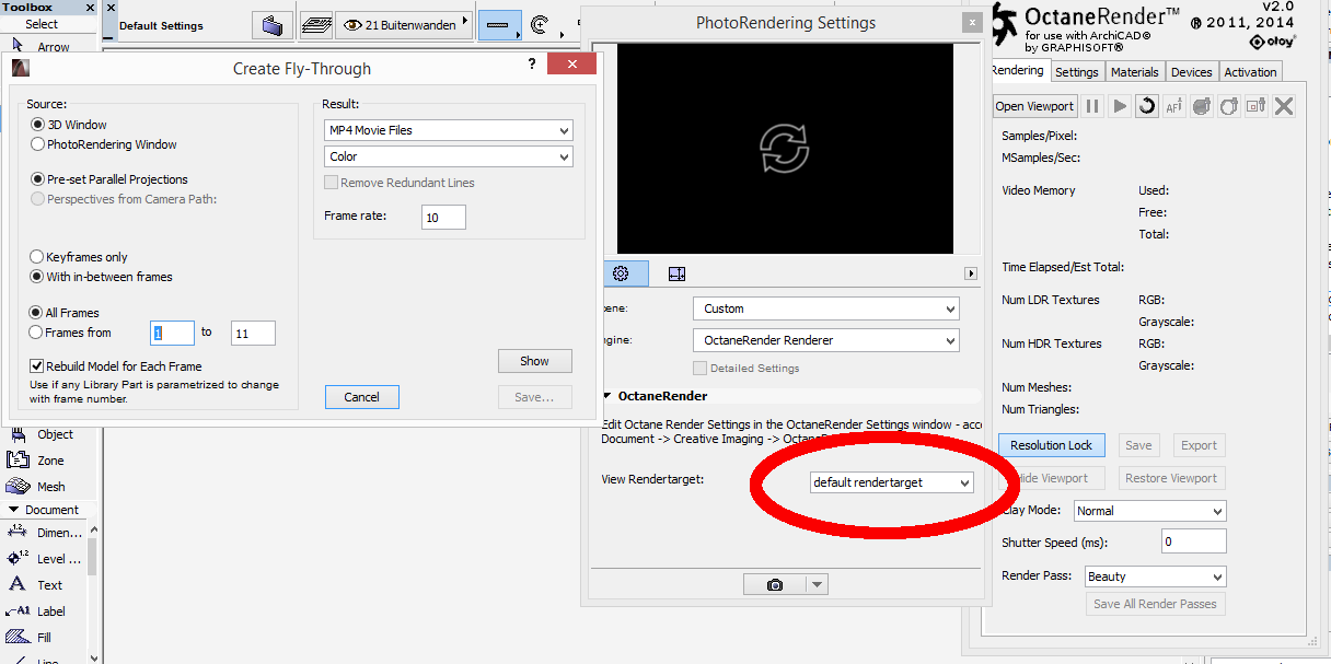

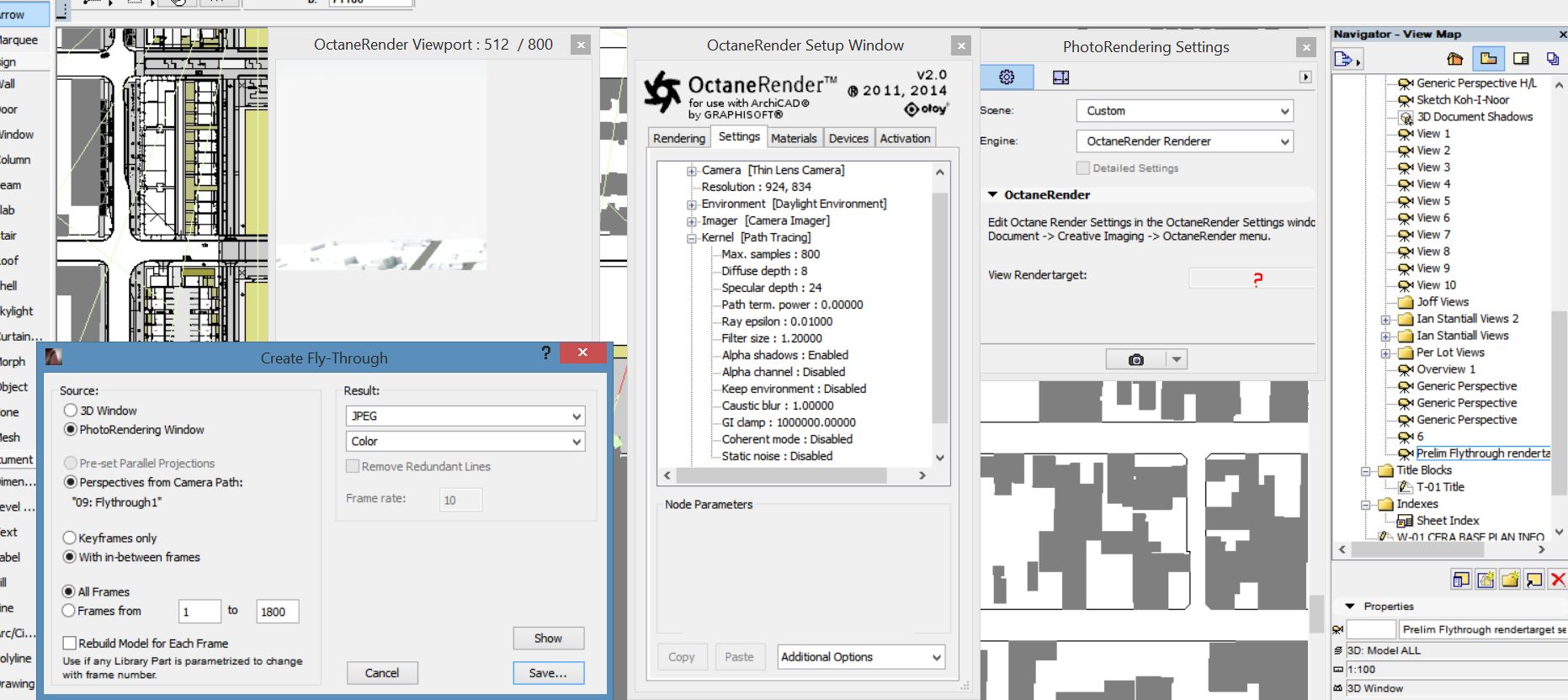

face_off wrote:
Hi Paul - for me, number of samples is incorrectly reported in progress indicator dialog (or my selection is actually being ignored or overridden by Octane somehow). If I select 800 max samples in kernel, render dialog reports the total samples as 300.
The max samples setting is being displayed correctly. Perhaps you have a different rendertarget set in the View combo box in the Photorender settings?
Paul
Hi Paul, you are very likely correct. Unfortunately, with either flythroughs or stills, there is no render target displayed in photorender settings dialog, even when the selected saved view does have a rendertarget, so no easy way to know. Is this an API issue?
Octane Render for ArchiCAD 22 plugin v4.x | Octane Standalone 4.x
( 2x Nvidia 980 Ti) x 6MB VRAM | Intel I7 4470K | 32GB RAM | Windows 10
face_off
Posts: 15733
Location: Adelaide, Australia
There should be a view (or the "default rendertarget") in the "View Rendertarget" combobox in the Photorendering Settings dialog. If you click on that combobox are their any rendertargets listed?
Paul
ArchPrime
Posts: 82
Joined: Thu Sep 25, 2014 11:39 am
Location: New Zealand
Hi Paul. Sorry for slow reply. No, there were no render targets showing in photorender settings dialog - that combobox just blank.
face_off
Posts: 15733
I tidied up some issues with this one or two releases ago, potentially after you first experienced this issue. May I suggest opening the plugin, then opening the Photorenderer Settings and select a View from the rendertarget combo box - and the problem should be resolved. If the rendertarget combobox in the Photorenderer Settings is blank (with the latest version of the plugin) - let me know, and I will investigate why this might be.
Paul
