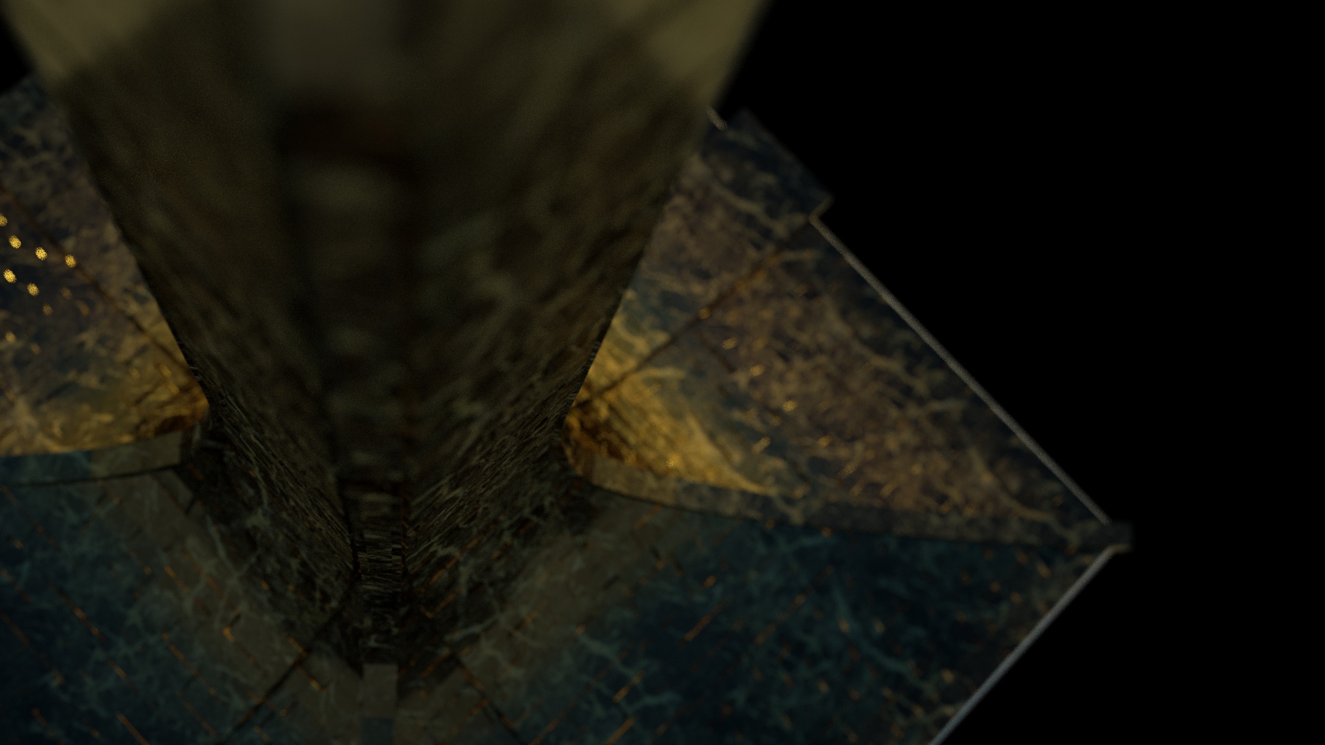

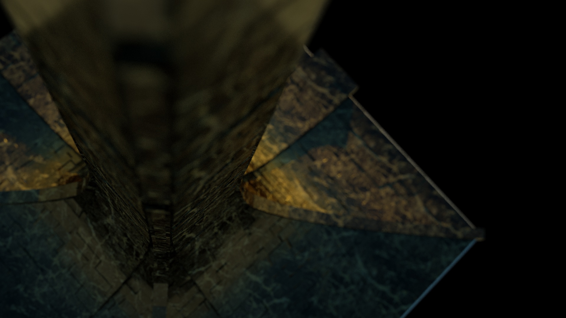

Hey, so I'm using version 1.52.1, and I'm having an issue where on the first frame of my render, the lighting looks very different from the rest of the animation.
It's almost like the diffuse depth is cranked on the first frame, and for the rest it's ignored.
Anyone else having this problem? Check out the difference between the first and second frames. The light comes through the cracks on the first, and then for the rest of the animation, it doesn't, and the shadows are much stronger.

aoktar wrote:maybe a problem on render settings. Can you try with overwrite kernel option?
Thanks, I really appreciate the quick response! Unfortunately, I enabled overwrite kernel with the default direct lighting settings and I'm getting the same thing.
I'll test on a different version of the plugin, and on a different machine.

I tried it out on C4D R14 (rather than 15) where I had version 1.00 RC1 installed, and it didn't have the difference on the first frame.
The funny thing is, I actually like the way that it looks on the first frame better, with the light coming through the cracks. Any idea what's going on?
here's the scene: https://www.dropbox.com/s/q20t0a6nzd342 ... t_0001.c4d
