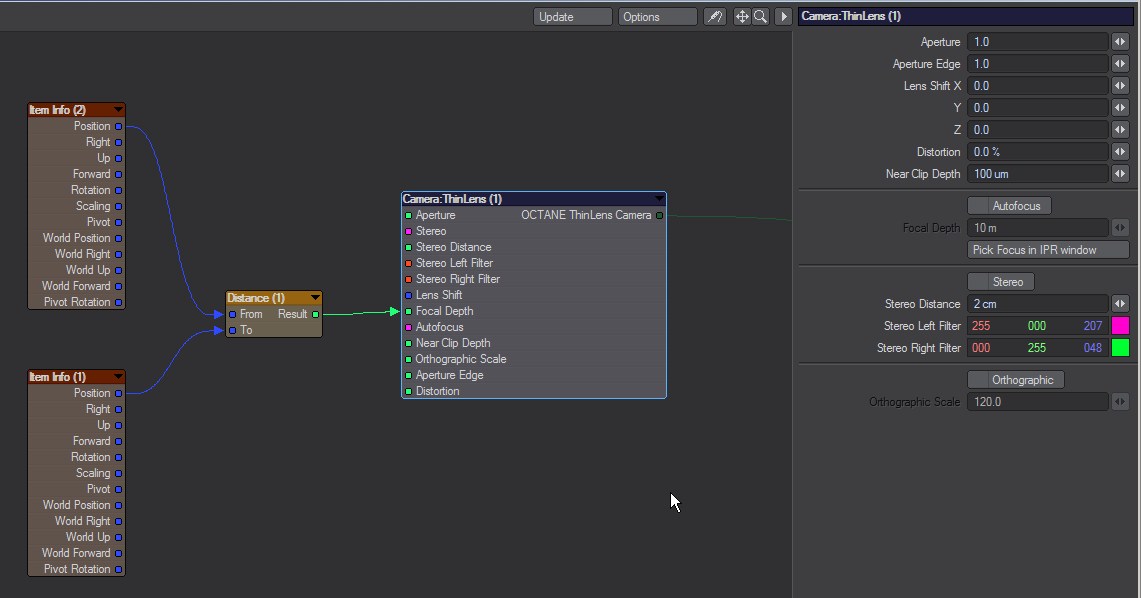

i need to have an animated depth of field effect for a project. Let's say there is an object and the focal point has to move through this object. I took a Null object and in the octane editor i tried to get its position to drive the focal depth input of the ThinLens camera with the ItemInfo Node. I made a quick animation of the Null through the object but there is no visible change of the dof effect. What am i making wrong?

You only need this setup. Two item info nodes (one for camera, and one for target null object) and the distance node. Be sure that you disable the autofocus option in the camera node.

Great ... this worked!
