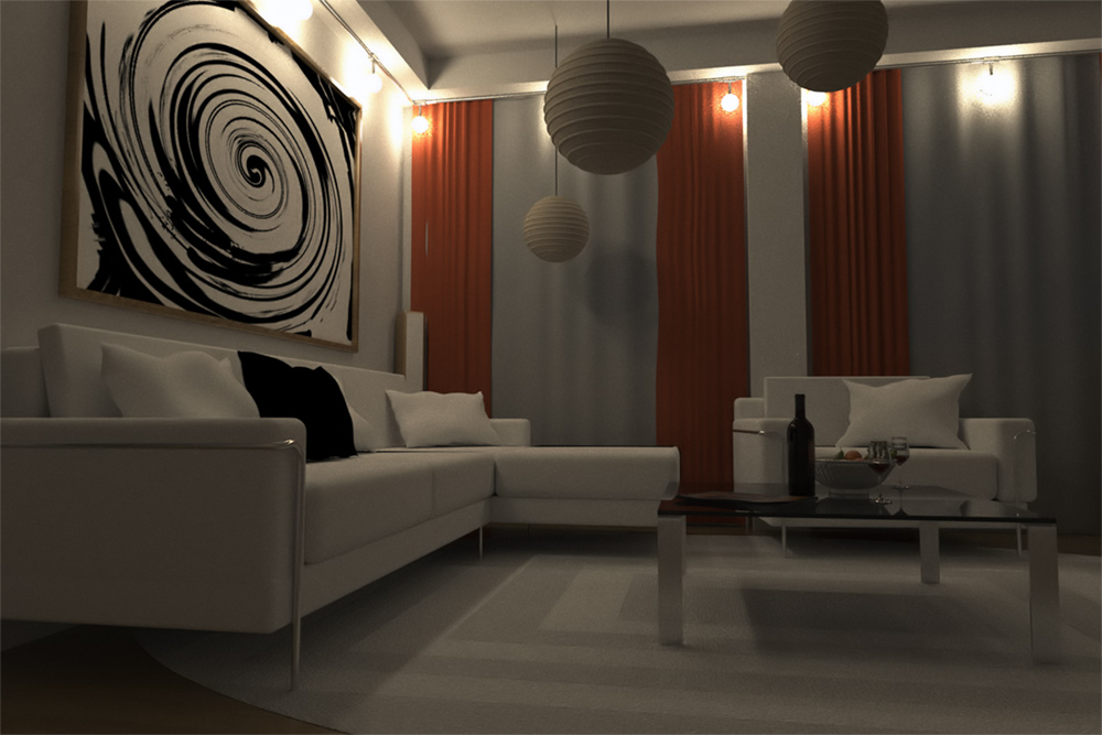

Test using mesh emitters using pre 2.3 V4.
radiance
Posts: 7633
great work, but why so much noise ? did it take a long time to converge ?
I really can't wait until we're %100 stable and full featured to finally start the last phase, optimizing.
Radiance
radiance
Posts: 7633
slight colour correction, scale and neat image makes the result pretty good.
please, can you tell me approximately how many triangles are emissive in this scene (all together) ?
and the hardware used for the render ? (which/how many active cards?)
it would help us a lot to optimize.
Thanks,
Radiance
MaTtY631990
Posts: 754
Joined: Thu Apr 08, 2010 8:38 pm
49,000 triangles for all emitters, and just a single GTX 470 used. These are just test renders which I only let converge for about 30 minutes. But I will submit a lot of interiors with night shots when we have a new algorithm implemented which you guys are working on and I just will love to see how it performs against MLT.

Heres a couple more renders using mesh lights.
15,000 triangles for the emitters. 2 hours rendertime on pathtracing. There's also an issue with normal maps being lit by emitters, as you see the detail on fireplace it should look like it is relief.
ROUBAL
Posts: 2199
Location: FRANCE
Very nice images, but I wonder : Why so many triangles for so few and simple emitting objects ?
I see only the flat TV (a rectangle : 2 triangles) and a small lamp. :shock:
Does it mean that you made all objects emitting light :?:
MaTtY631990
Posts: 754
The triangle count are just for the bulbs, which there are 5 in total, but you can only see one visible.
ROUBAL
Posts: 2199
Location: FRANCE
OK, but why so many polygons for so simple shapes ? Would it be really noticeable with less ?
I have tried to model a flame bulb like yours, and I got 72 quad faces (144 triangles for one lamp with enough detail). From distance with smooth applied, you will not notice that it is not subsurfaced.
I applied a subsurf level of one and got 272 quad faces, so 544 triangles. For 5 lamps , you get 2720 triangles... still far under your 15000 triangles, and my original lamp extruded from a circle of 8 vertices was more detailed than necessary !
