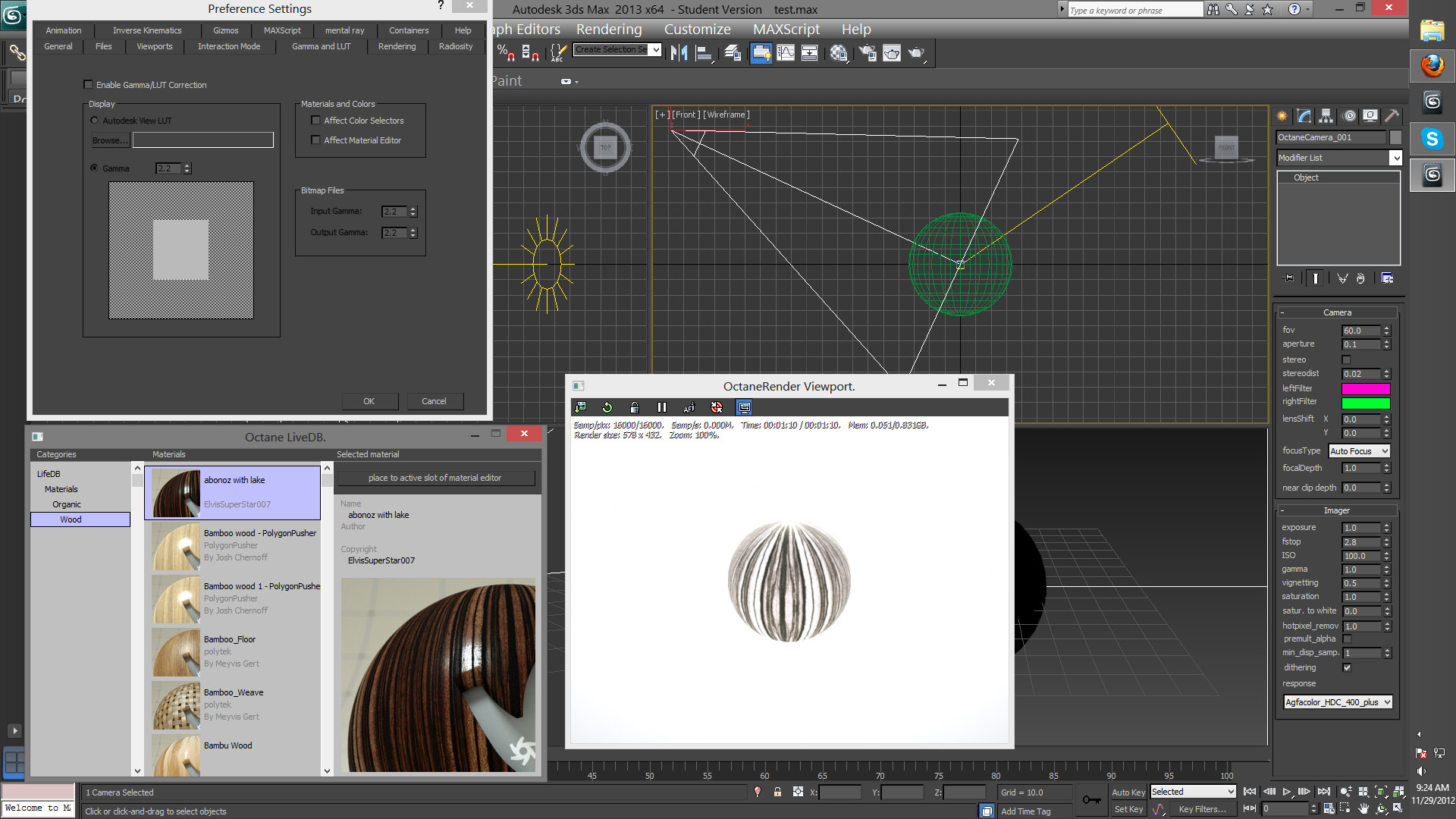

The colors are strange. Am I doing something wrong? Using 1.0 RC3, Max 2013.

look imager in "camera settings"

jcuratolo
Posts: 12
Joined: Wed Oct 10, 2012 6:38 pm
Vanya wrote:look imager in "camera settings"
Playing with the gamma there doesn't fix things. Tried both the modify panel and render setup locations.
Vanya
Posts: 161
Joined: Sun May 13, 2012 7:26 am
Location: Cyprus
if you have a camera in the scene, setings in "render setup" does not work, they work in the camera setup.

jcuratolo
Posts: 12
Vanya wrote:
You mean in the modify panel? I already tried that. Additionally it doesn't address the mat previews. Thanks for your help, though.
suvakas
Posts: 503
Joined: Sun Jun 12, 2011 10:26 am
Disable Max gamma correction.

jcuratolo
Posts: 12
suvakas wrote:Disable Max gamma correction.
Suv

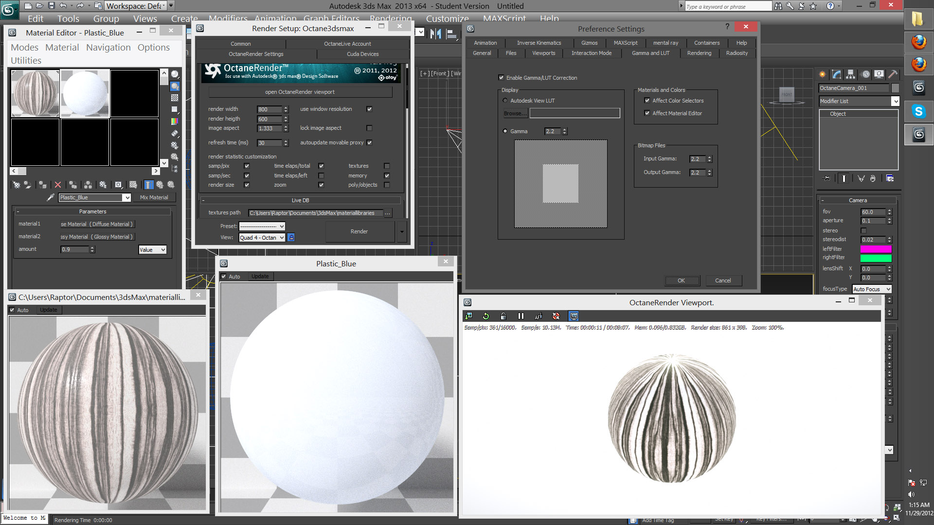

Same deal, negligible improvement. I'm haven't a clue what this could be from.

Karba
Posts: 2300
Suv
To use octane camera image settings you have to click to camera viewport (perspective), otherwise octane uses settings from render panel.
What inveronment do you use?
jcuratolo
Posts: 12
Karba wrote:
Suv
There is no environment map right now, just octane sun, octane camera, and sphere with liveDB mat. Everything else is as it was installed.
Karba
Posts: 2300
jcuratolo wrote: There is no environment map right now, just octane sun, octane camera, and sphere with liveDB mat. Everything else is as it was installed.
Your sphere looks overexposed. Try to reduce exposure.
