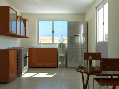

original size 2000 x 1500 px, dpi 72, resized to 1600 x 1200 px, dpi 72, maxdepth 8, maxsamples 6000, time 1 hour 28 minutes, kernel type pathtracing, stand alone version 1.0 RC3
regards

Hi merid,
harder "project" this time (lots of objects). I think that the illumination is ok but the most part of the objects in the scene lacks of details, moreover there is no one texture in the scene (except for the one of the back ground)....this makes your work an uphill road.
I think that the only things that works for the moment are the refrigerator and the "composition" table+chairs+objects on the table.
Cheers, Paolo

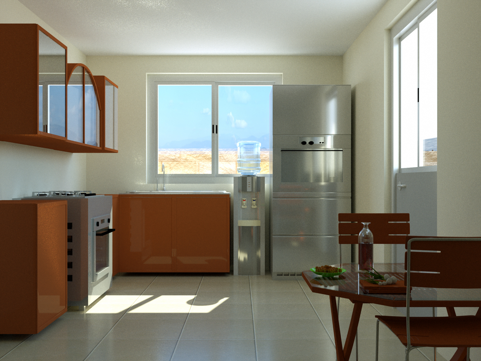

I have to agree with paoloverona. You have a good scene setup for a lot of optimizations need to be done to make an better render. Your kitchen cabinets,tables and chairs could with a wood texture on them. Also give your objects rounded corners and this will add the extra realism. Take a look at photos of kitchens which you should use as source of reference and keep a close eye to the edges. For that remaining noise, maybe try with PMC kernel and see if it's better result for same time. Or for faster result why not try the diffuse GI mode and set to 8 bounces and have a good number of specular/glossy depth for the glass materials.
MaTtY631990 thank you for your comments, but i can't understand pmc, i can't use it, the values for me is a big problem, i don't know how use it
