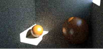

ok, here is my test scene, im not all sure what you mean by global illumination but iv turned up the power of the enviroment:
what should i do now?visit my website at http://www.ionee.org

ok, did that, all looks very dark. turn'd up all the power settings and there is a tiny bit of bleeding but nothing like the images

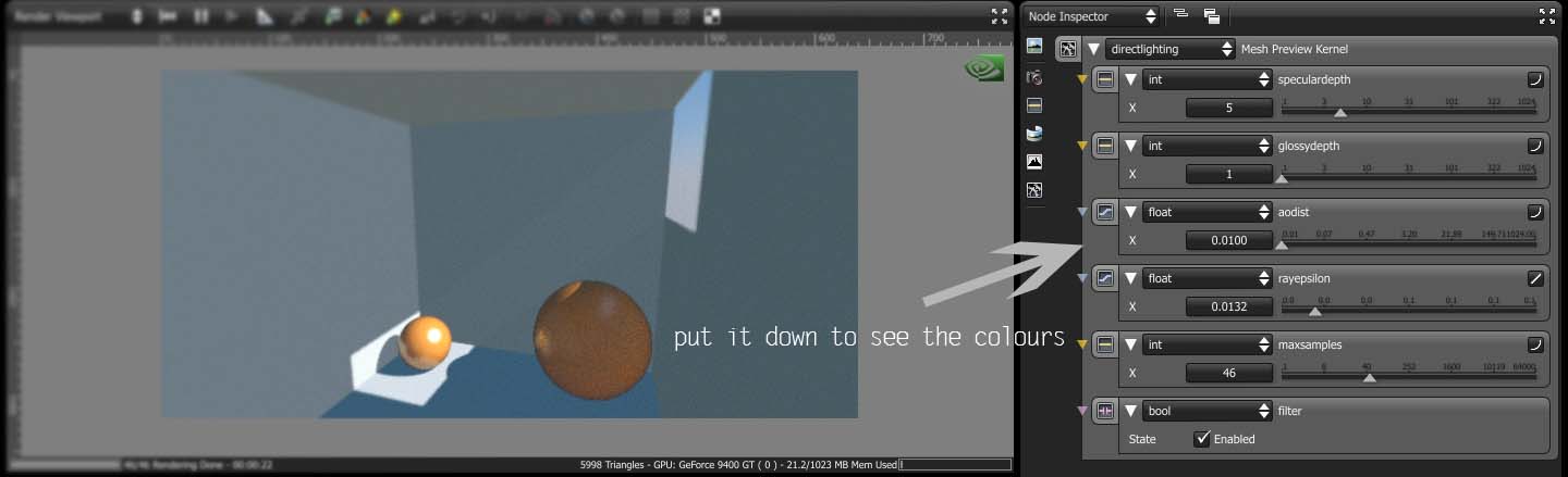

Now it looks realistic. Try to work with camera options. This is theory about Colour Bleeding:

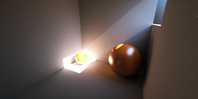

thanks for the illustration, it really helped me understand how octane renders colour bleeding.
here is what i have now: is there any variable that controls the colour bleeding?

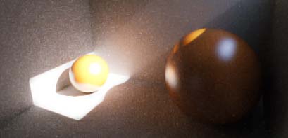

here is my finished testy product: so, to those who want to know how to do it, here are the best settings:
• Use the Path-tracing render engine in octane
• Use STRONG lights in octane, ie. strong power setting for the environment then follow steps below
• Use a low Gamma setting to increase colour and contrast
• Mess around with the exposure to get a good looking image
• Tag of Vignette
Thanks again, ionee
