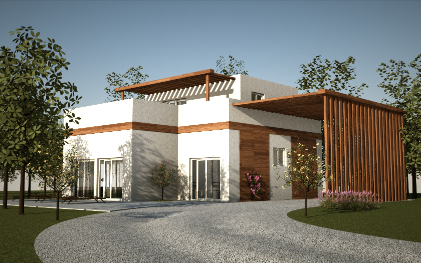

Hi all!
Here's a model I made to continue my modelling and rendering training...
Most of it was modelled in Sketchup (with imports of trees from the SU warehouse, hence the low quality of the trees... :(), rest done with Blender.
Please feel free to comment - I need to improve my skills !!!
:D
I'm really looking forward to Octane being able to render Normal Displacement and Alpha Render !!! If you have any tips regarding these aspects feel free to help...
Regarding Alpha Render I thought about doing it manually by turning all the material's Gamma to the full, in order to get the black outlines, and putting a plain white RGB colour in the background... I'll try this and let you know...
:mrgreen:
Render stopped after approx. 2000 samples per pixel

For alpha check this, is an easy setup and about the same you suggested http://www.refractivesoftware.com/forum ... 50&start=0 on the displacement do a search, I think Radiance said it won't be implemented in the near future (althou I think he makes a hobby oout of making impossible things happend and surprise us that who knows ;) )
About the render, it's looking good, but the textures need more work, right now you can see them tile, for the grass there is lot's of tricks, if you are going to take all low shots you could go for scattered planes with an alpha map, or if you are going to take higher shots you could try to use poly patch of small grass blades, as low a 1 triangle per blade and throw a bunch of them.
For the tree leaves use translucency with a custom made map of the leave "nerves" it improves a lot the feel of them, check the forum wip also there is a ton of examples.
And finally, are you using pathtracind or directlight?
windows 7 x64 | 2xGTX570 (warming up the planet 1ºC at a time) | i7 920 | 12GB

Thanks for the link regardin Alpha, useful stuff indeed!
:D
kubo wrote:if you are going to take all low shots you could go for scattered planes with an alpha map, or if you are going to take higher shots you could try to use poly patch of small grass blades, as low a 1 triangle per blade and throw a bunch of them.
"scattered planes with an alpha map"... I don't know this technique - could you explain a bit more?
:oops:
I'm at work right now and don't have access to Octane, so I can't tell you if I used pathtracing or directlighting. I just remember using "daylight" instead of "background image" (or whatever the name is for this in the menu) and checked the "filter" option (the manual says it's better for photorealistic results)
What's best? Pathtracing or Directlighting?
Many thanks for your comments and your help Kubo !!!
:D

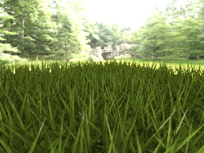

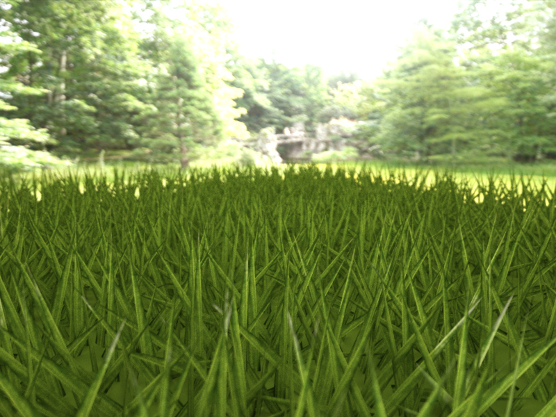

Hi!
Here's a quick "grass test" using 1 triangle, scattered randomly using the "Hair" function in Blender.
This technique (although I used only 1 triangle per leaf) is quite "poly-hungry" as you said...
- I UV-mapped the "leaf" that was to be scattered and applied the texture
- I turned into B&W the original green texture, reworked it a bit so that the end of the leaf gradually fades into white
=> I used this as my mixing map as a "floatimage" in the "Opacity" menu
=> I also used it as my specular map (got lazy on that one! :mrgreen:)
I made 2 tests: First one using Directlighting with Filter Off
Second using Pathtracing with Filter ON
Without changing any other settings : just to see the difference....
Maybe I'm a bit "weird", but I prefer the one using DirectLighting, whereas (as you said) Pathtracing is supposed to look better...
(or maybe I need glasses! :ugeek:)
Please keep commenting!
Cheers!
:D
PS: both images = 1000 samples per pixel

yeap in this case it does look better the direct one, but that's not usually the case.
Btw, nice one considering just one blade, and I like the texture.
