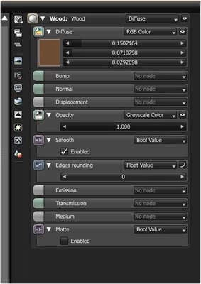

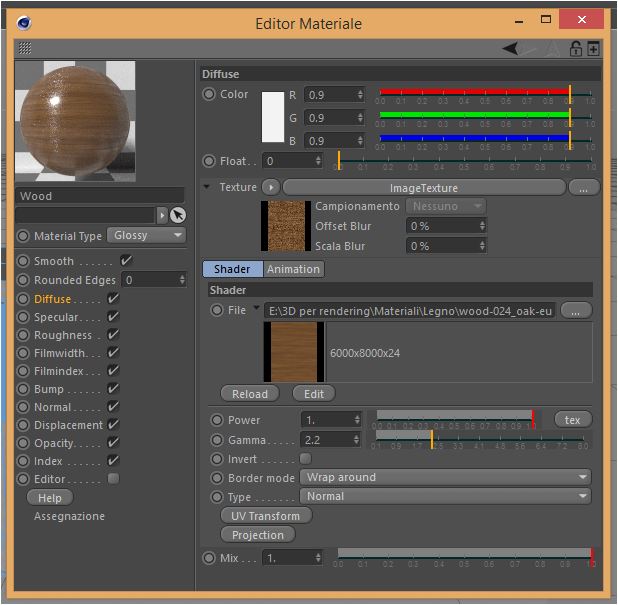

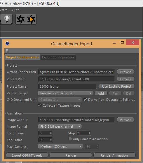

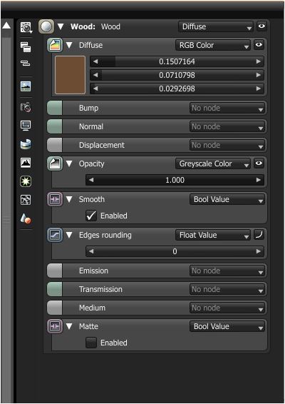

I refer to Octane Export plug in not to Octane render plugin for C4D.
As you create a material in C4D with the plugin of Octane Render for C4d and export to render on Octane Standalone with the OctaneExport plugin the link to the texture images of the materials will be lost, as you can see on the screen shots attached.
"Collect all texture images" doesn't works.
material output on Standalone
material created in C4D

window of Octane Export - "Collect all Texture Images" is selected

augdalmo wrote:I refer to Octane Export plug in not to Octane render plugin for C4D.
Yes it works but only with very simple materials and only when they are the standard C4D materials. That's mostly because OBJ/MTL doesn't allow any fancy materials and because the materials of the C4D Octane plugin are not documented and subject to change (and at the time I wrote the export plugin the Octance for C4D plugin didn't even exist).
But since you are already using the C4D plugin you can use the plugin to export the scene to Octane Standalone using the Octane Dialog and selecting File -> Save Ocs.
