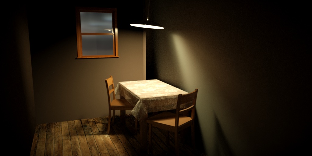

Decided to give your model a quick test.
When there is no specular glass in the scene, I noticed for my own that results with Direct Lighting is nearly the same as pathtracing, and faster. But I have to say that I mainly do external scenes currently. However, I tried these days on the interior views of my current red bus scene, and noticed no difference except rendering time.
TBFX, I tried to set aodist and it works pretty nice, thanks. With path tracing the result is still more realistic, though.
Tugpsx, it's not entire model. What kernel did you use and what was the time of render?

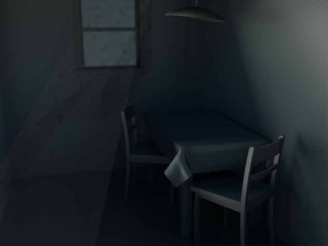

What I really want to do is a kitchen in the morning. Low light with volumetric dust / light / fog through the window. That's why I need the room to be dark, so light coming from outside would be visible. Something like this > http://www-graphics.stanford.edu/course ... ndoned.jpg although it is not the inspiration I'm using.

That was PMC rendered on GTX480 in about an hour to cleanup fireflies.
I did one with pathtracing and it was quicker, but had more fireflies for 16000 pass.

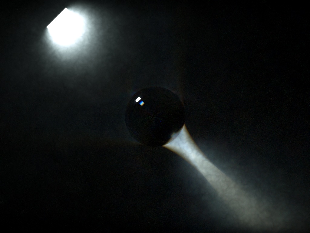

BTW tested the volumetric lighting but had to use an object for the light to pass thru for the effect. We talked about using planes for this before, there is an example here somewhere that shows a pinhole in a darken room for caustics and volumetric light.
It took forever to cleanup enough to be considered.
