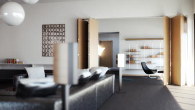

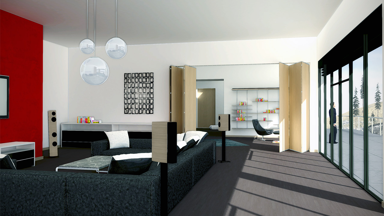

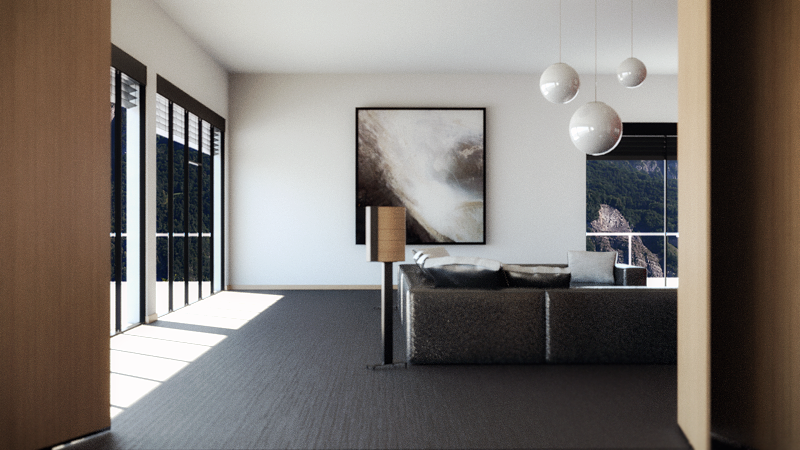

i don't know how the difference between the first and the third render: the third seems to be a close-up ot the first, but the first looks like a toon render when the other looks photorealistic....can you explain?
Thanks, Paolo
Thanks, Paolo
intel i7 3820 3.6GHz, 16Gb 1600Hz, windows 7 professional 64bit, gtx 580 3Gb x2, Octane 3dsMax 2.58
The first "render" is a screengrab from the real-time version made in a game-engine with custom features I added for arch-viz (mostly reflections, AI and mocap data). You can walk/fly around and take a virtual tour in the house with free movement.
The other two are rendered static in Octane. YOu can't move in real.-time but do better visuals of course as in a game engine.
THe good thing is taht the scene is the same but with OCtane the conversion was very easy and I saved a lot of time for modifications.
