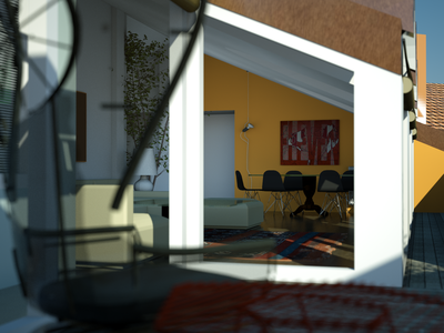

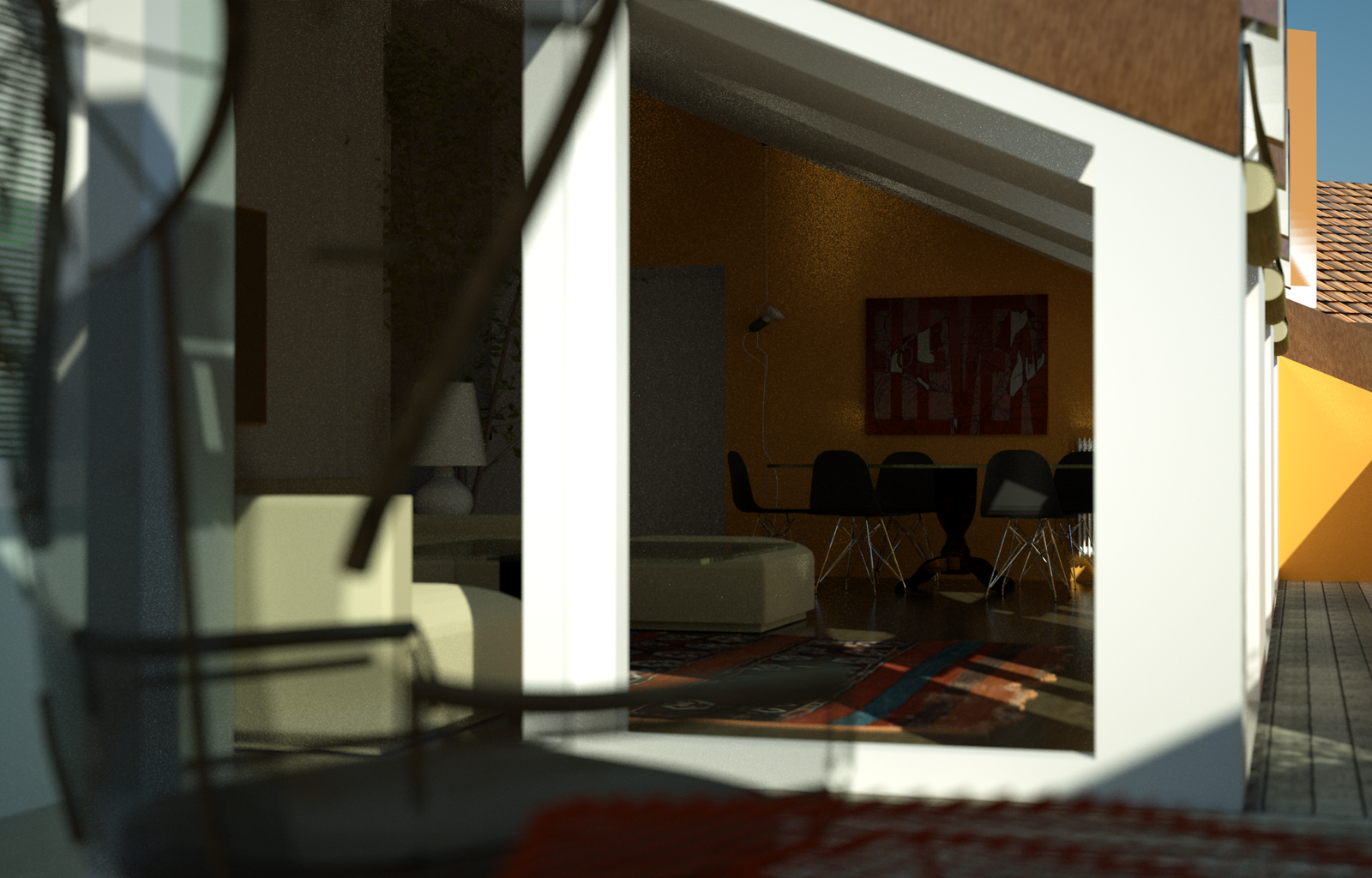

I've rendered the same scene in direct light and pathtracing (following the "radiance procedure" involving double resizing via photoshop).
The time request by the two is quite different (20 min. vs 2h.40 min.) and it doesn't seems to me that it correspond to a visible gain in quality.
It is prob. my foult in not doing the necessary corrections to obtain better results, so I simply ask for any suggestion to exploits the right setup.

I have to agree that the quality tradeoff for speed may not be worth it. Direct lighting is often quite beautiful and much faster.
It might not be as accurate, but I really like the results.
It will be intereresting to see other comments. I saw in another thread where is was mentioned that direct light was more of a preview mode where pathtracing was for final image creation.
For a "preview", your direct light image sure is pretty.

hi,
actually I didn't exported the glasses in the obj file, maybe the pathtracing problems arise by doing it on the laptop which downspeed too much the process, btw I'm pretty happy of the results using directlight.

I think it all goes for what you are looking for. Direct lighting gives a good quality render without all of the refined detail of pathtracing. Pathtracing is more for realistic scenes/renders where you need to mimic the real world. The direct lighting render above looks great, but it doesn't look "real". Granted the pathtracing doesn't fully look "real" but that could be settings. Not sure why the light ins't coming into the room if there is no glass there. Odd.

I also believe that pathtracing need much more time than directlighting while the results are not than different sometimes.
Maybe when emitters and RLT are here we could judge better, but until then I go with directlighting for most scenes I test.

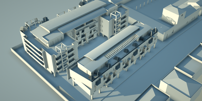

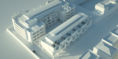

in few situations very similar. absolutely different in others
the following two images shows a very fast render with white material (better to evaluate the lighting difference than complex materials. the file and settings are the same except for switching between path tracing and directlighting
(by the way, the buildings are a current work of my studio)
xp64 professional - asus p7p55ws supercomputer - i5 750 - 16giga ddr3
cuda: 2 nvidia TITAN
pathtracing looks very good, Hope radiance can do better to directlighting, Quality similar to Vray. this's a commercial job needs. Physical body is not realistic for commercial render work.
