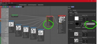

Not sure anyone reported it yet:
Gradient on complex mode is not updating the node pins, wheter it's new gradient node or an already existing complex gradient where I am eliminating values.
Sometimes it updates, sometimes it doesn't.
Pins not appearing or being removed

Kalua wrote:Plugin is working great, Aoktar! Thanks!
Ok I'm checking it, not reproduced yet but thanks! You can press to "Get active material" as work-around. Sending a sample scene may help to see the issue
Thank you. If I find a consistent reproduceable scene I will send you.

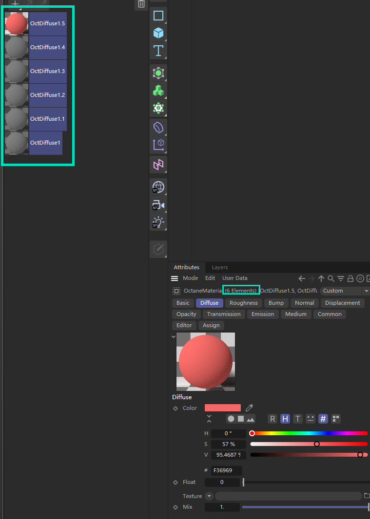

modify multiple material colors
matertial preview, not refresh
i test on v2021.1.4-R4,it's ok
on v2021.1.6-R6,v2022.1,it noesn't work
