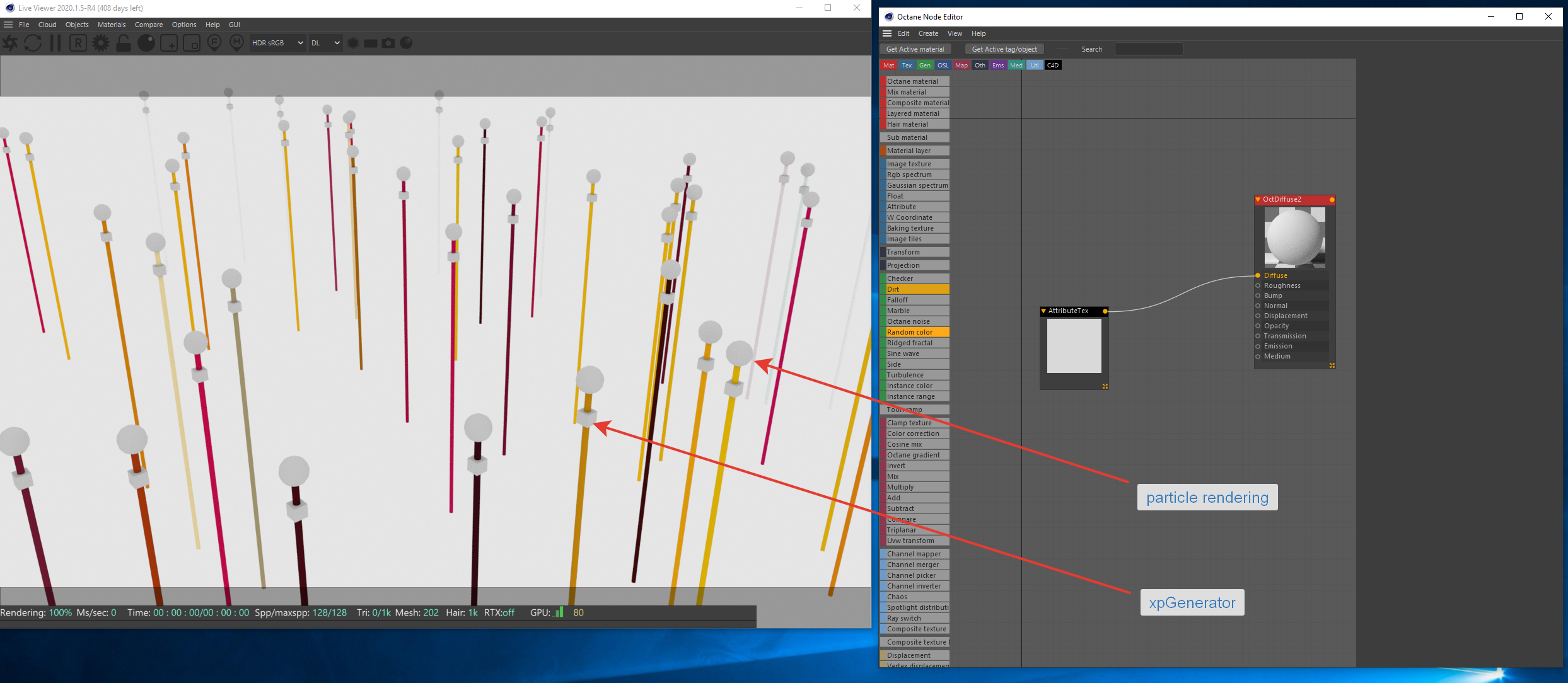

Hi Aoktar!
Is it possible to use color data for particles itself?
I use texture emission to drive color of the particles, and can get color for trails, but not for the particles. It is so close, yet seems to be quite far away.
Particle Color Form Emittion.7z
Project File

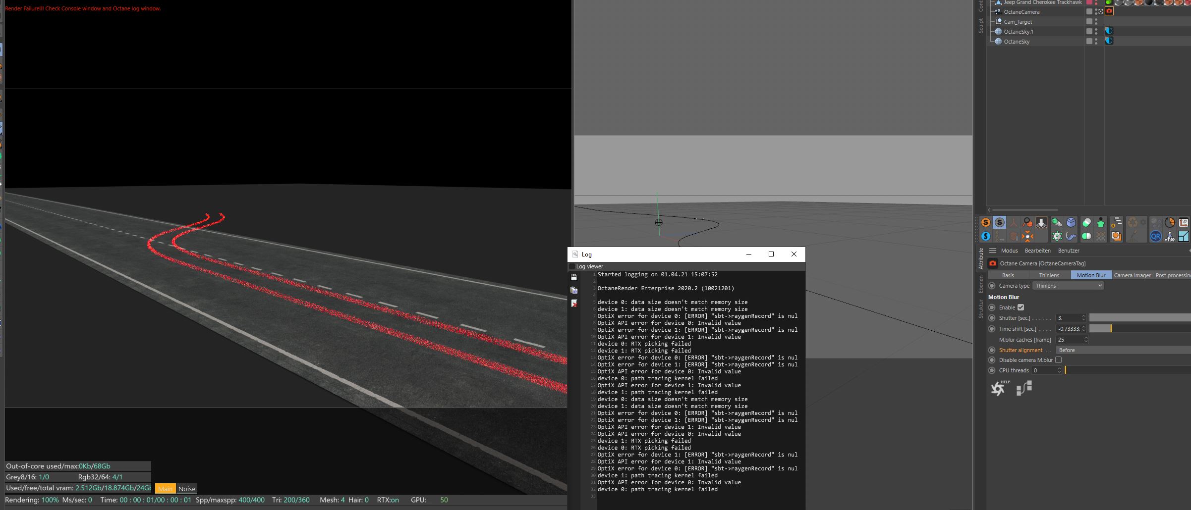

still testing motionblur!
When trying to get something like car-light streaks
I get following error!
Any tips on how to set up this kind of MB without crash?
regards
Mike
Posts: 16068
Location: Türkiye
miohn wrote:still testing motionblur!
regards
Mike
Why are you using extreme values for motion blur? Rtx and this can cause that, it's my assumption from your single picture
Hi Ahmet,
I'm not a photographer, but from my understanding I thought, when a car takes 2 seconds to come from a to b,
and I want a light streak the whole length from a to b, I need an exposure of 2 seconds. Not?
Anyway - "RTX" is a good tip! I have this "on" all the time.
Mike
