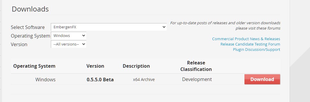

https://rndr.otoy.com/ says I'm logged in, when downloading embergen 0.5.5.0 via the homepage and try logging in with the my otoy infos, it says not licensed and quits... -.-
Any help?
Edit: I'm on thw all access plan (until 25.12.2020) but also subscribed for the RNDR+. Why are there alway problems with the licensing processß Why can't I download the latest 0.5.6 version from their site and log in with my Otoy account? Losing work time because of such unecessary BS is so frustrating...
Edit: for whatever reason, it worked after downloading and copying the fails again. So we are good here. :)

Otoy update dowload link to 0.5.6.1!
Win 10x64, AMD 1950x 16C/32T, RAM 32Gb, RTX 3060x3
Octane-for-C4D(R23.110)2021.x.x, Cycles4D, Centileo. Nvidia 472.47 STUDIO
Goldorak
Posts: 2321
Joined: Sun Apr 22, 2012 8:09 pm
VVG wrote:Otoy update dowload link to 0.5.6.1!
it auto updates, but we’ll swap it in with the new version shortly.
VVG
Posts: 301
Joined: Sat May 07, 2016 2:34 pm
Come on! timely change on the download site
Thank you

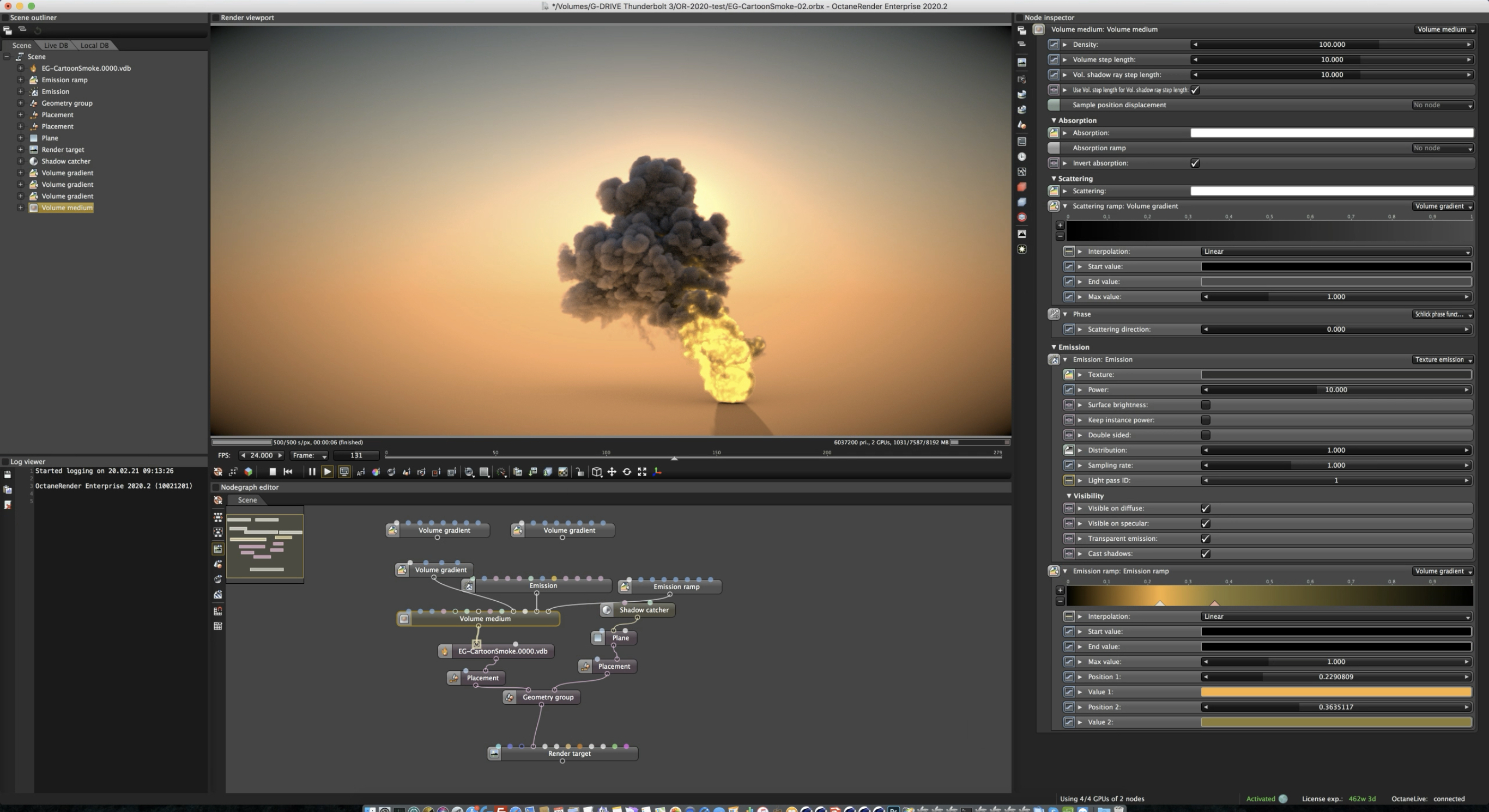

I've read the previous posts about the correct workflow for EmberGen to get the volumes to color correctly, but they seem to apply to other plugins, and to previous versions of EmberGen. What is the workflow for Octane Standalone(or for the Lightwave plugin)?
Thanks;
Rob Pleak
Posts: 10606
Hi Rob,
I’m not a LightWave user, but I’m quite sure that it should work almost in the same way.
Here is an example of EmberGen vdb rendered in Standalone 2020.2:
ciao Beppe
rpleak
Posts: 6
Joined: Thu Apr 05, 2018 2:35 am
That looks great!
What parameters did you use to get these kind of results? I'm sure that there were adjustments on both Embergen and Octane to get these kind of images. What I see in my in both standalone and the plugin are poorly defined blobs, overexposed flames and no dark smoke.
If I had a starting point, I think I could figure it out, but there are so many variables to set in both EmberGen and Octane, that could spend months trying to figure it out(if I didn't bash my head against a brick wall before then). Keep in mind, I'm just a hobbyist, and I'm just starting with VDBs...
How did you get a handle on how to do it?
Thanks;
Rob Pleak
Posts: 10606
look at how is made the Gradient Ramp in EmberGen, and try to replicate the same coloring in Octane Volume Gradient/Ramp node, in both Scattering Ramp, and Emission Ramp.
The trick is to always start with a black color from the left.
Happy GPU VDB rendering,
ciao Beppe
