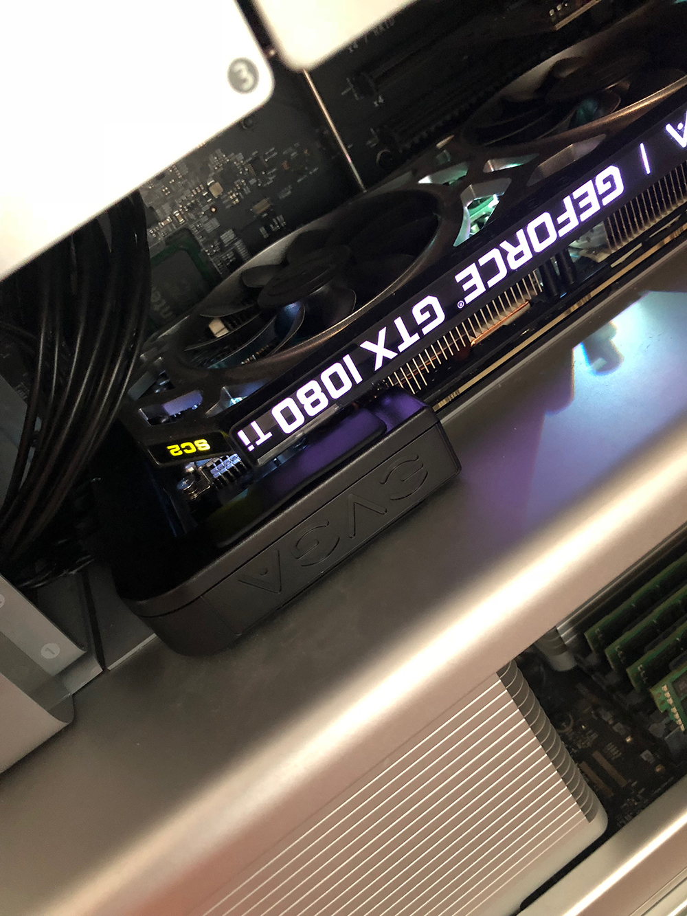

So I work on the Mac, too. My computer is a Mac Pro 2010 with two gtx 1070. my system is high Sierra with the security update 2019-002 nr 2 :-). Cuda driver is the 410.130 and web driver 387.10.10.10.40.124. I can work with it. There are no kernel panics. I once had a Titan x in my Mac, maxwell generation. And I had stability problems with it. I think it was the problem with the power supply. A 250 Watt card with only 225watt to operate does not work well. And results in system crashes. PCIe slot gives 75 watts and the two Mini pci power cables each only 75 watts. So I built in the two 1070 which need 150 wat per card which fits exactly. Pcie slot + cable equal to 150. I don't know your configuration but if you don't supply the 1080ti with enough power you will have crashes.

DERJUNG wrote:So I work on the Mac, too. My computer is a Mac Pro 2010 with two gtx 1070. my system is high Sierra with the security update 2019-002 nr 2 :-). Cuda driver is the 410.130 and web driver 387.10.10.10.40.124. I can work with it. There are no kernel panics. I once had a Titan x in my Mac, maxwell generation. And I had stability problems with it. I think it was the problem with the power supply. A 250 Watt card with only 225watt to operate does not work well. And results in system crashes. PCIe slot gives 75 watts and the two Mini pci power cables each only 75 watts. So I built in the two 1070 which need 150 wat per card which fits exactly. Pcie slot + cable equal to 150. I don't know your configuration but if you don't supply the 1080ti with enough power you will have crashes.
Thanks for this.
The card was installed by a third party company who also upgraded the CPUs and flashed the Mac from a 4,1 to 5,1.
How can I find out if the 1080ti is getting enough power, please? Before the 1080 was installed the Mac was completely stable, but since then the kernel panics have been regular. Really disruptive and annoying.
I have the card installed with a Powerlink adaptor.
