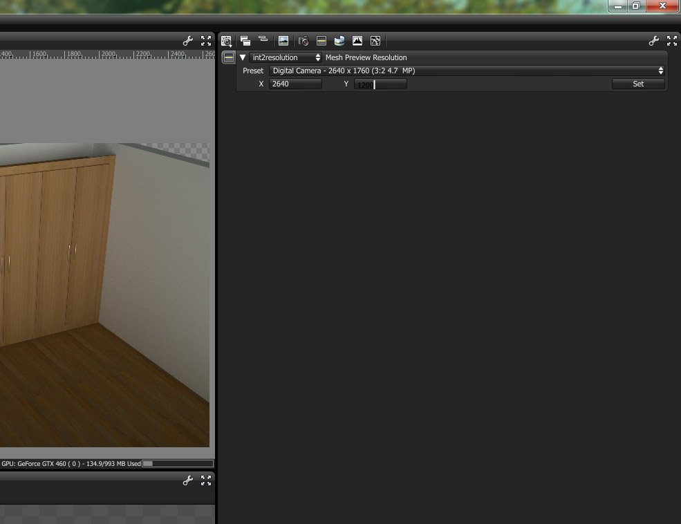

Thanks for the set button in the image preview resolution .It works great.
Only one very small issue.The numbers turn to black on black background as you alter them.They do however return to white when you press the set button.
Could they not stay white on black instead as you alter them.It makes them easier to see.
Cheers
