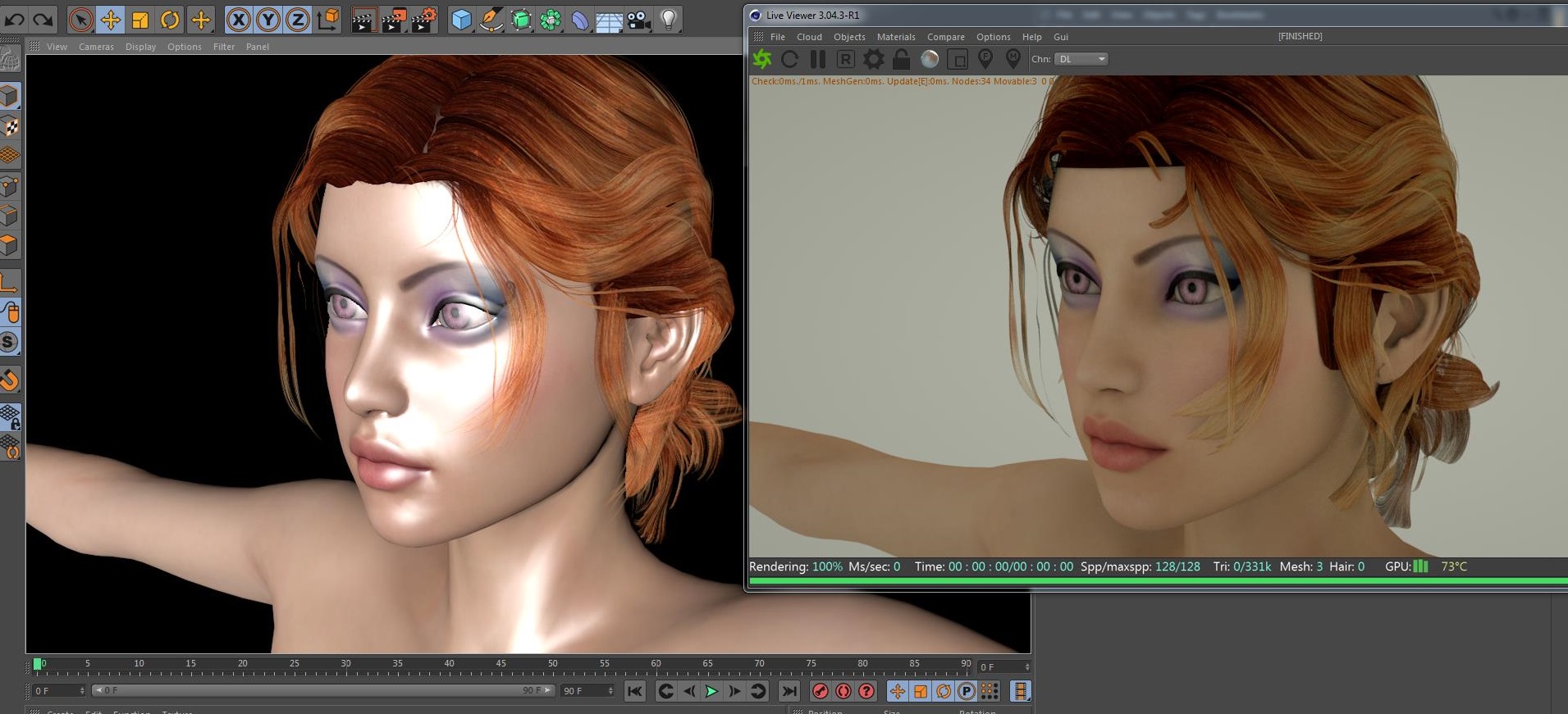

MATERIAL STACKING LIMITATIONS
- Only works with c4d materials and octane materials and will not work with mix materials in any combination
- Works on movable meshes. So it requires to be in auto mode for LV or auto detect for PV or object tag in manual mode. Doesn't work on "Send all data" method.
- Works with flat/cube/cylindrical/spherical projection types. Tiling support. Doesn't account the current tag's UVW mapping coordinates. It takes it from previous material which has not alpha/opacity.
- Can work with selection assignments. But it's still limited on complex selection sets
- Go with mix material setups for advanced usages
Hello!
Does the above mean that if I created an Alpha channel in C4D for a material (that didn't by default have one), it will not render in Octane plugin?
I am seeing alpha "maps" (images applied as a texture in Alpha channel meant to mask out a white/black non-png background) recognized correctly in C4D's workspace viewports and C4D's default renderer itself, but not in Octane (see the scalp/hairline in the below image)
Ironically I want the hairline to recede
