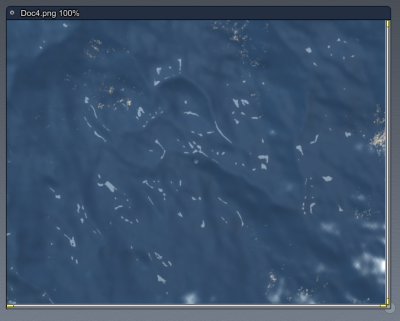

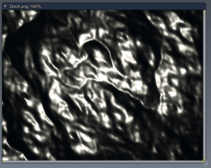

Please help. Can't get the OctaneRender for Carrara (stable OR test) to render color/materials. I believe I'm using the defaults (use the Animated Ocean example). Here's the PhotoRealistic vs OctaneRender. (somehow the TEST version was a bit lighter - stable is pictured). [same thing happens with any of the default scenes, shapes only]
Photorealistic: OctaneRender:
