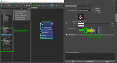

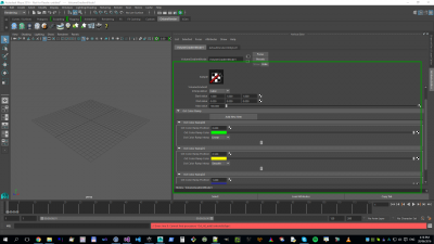

Indeed I need to override the AE***template Mel procedures. Latest the standard UI for an MRampAttribute is utterly useless:
Standard UI: Custom UI is better: You can see all new nodes here in their category "Octane NG" as well.
Autodesk support says as well its the standard way, and every plugin has to do it.
So finishing the last quirks with that.
Then all AE**templates for all the new nodes are overwritten, so they have the same structure.
Since I now (few fixes away) have reusable Mel scripts building the UI of all nodes and don't hardcode attribute names in Mel anymore,
it will be less error prone (especially when standalone changes attribute names in a new version) and quicker for me to introduce new nodes.

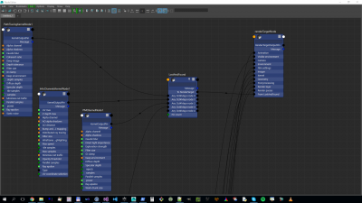

Solved the problem of unconnected nodes floating arround freely in the outliner with a new node type...Lost & Found:

The Lost&Found node is a first idea & implementation how you can keep every node connected to rendertarget, so one click gives you the whole nodegraph.

I see,k.a.schubert wrote: The Lost&Found node is a first idea & implementation how you can keep every node connected to rendertarget, so one click gives you the whole nodegraph.
the node editor display nodes based on selection and connected nodes,
so you keep a connection for all octane nodes to display all of them in one click.
I'm concerned by the number of nodes tab displayed in the attribute editor with this system.
And I'm not sure we really need this, because the same can be done with a one line mel script, I think.
Also this may be redundant with the (new)hypershade UI:
In hypershade we can see every shading nodes by categories and just drag and drop them in the Attached Node Editor as we need them,
and optionally we can add an octane "show filter" to only see octane nodes in the categories.
Anyway just guessing here, maybe when I 'll try the lost&found node I won't be able to live without it anymore
