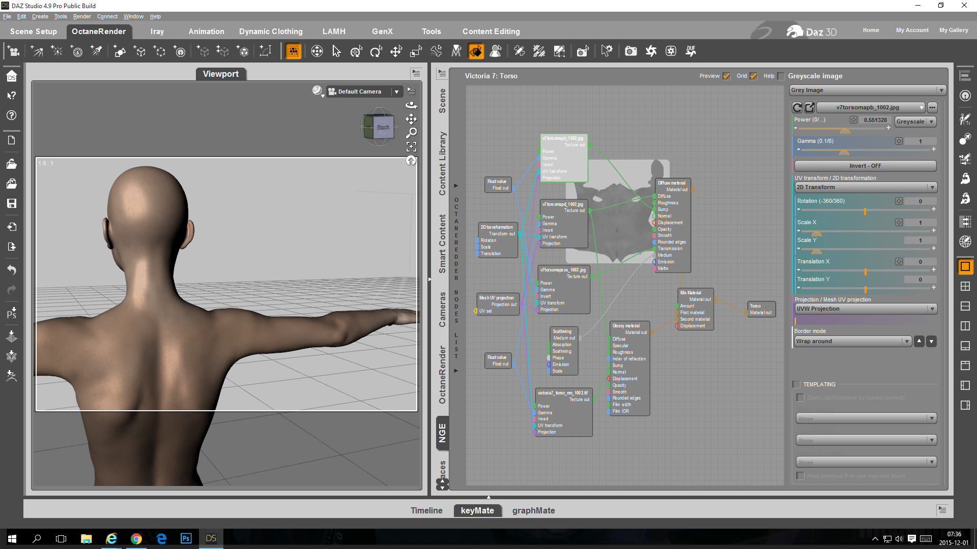

face_off wrote:The have refreshed the installer at the top of this thread with:
2.24.2.4
- Removed the creation of material mix nodes when there are both normal and bump maps. Normal map is used if there is one, otherwise the bump map is used (if there is one)
I am not sure if this is already working as intended:

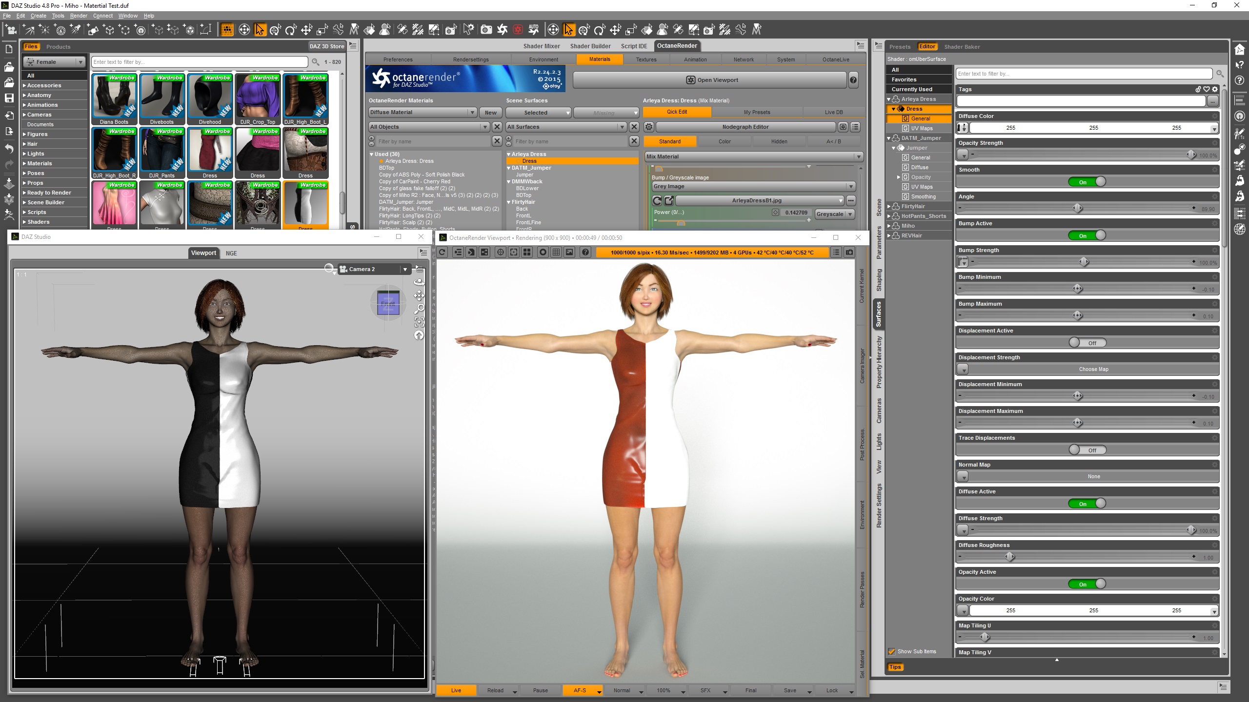

Installed 2.24.2.4
Tried with Victoria 7 and there still are bump and normal maps and a mix material in the scene:

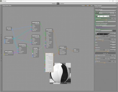

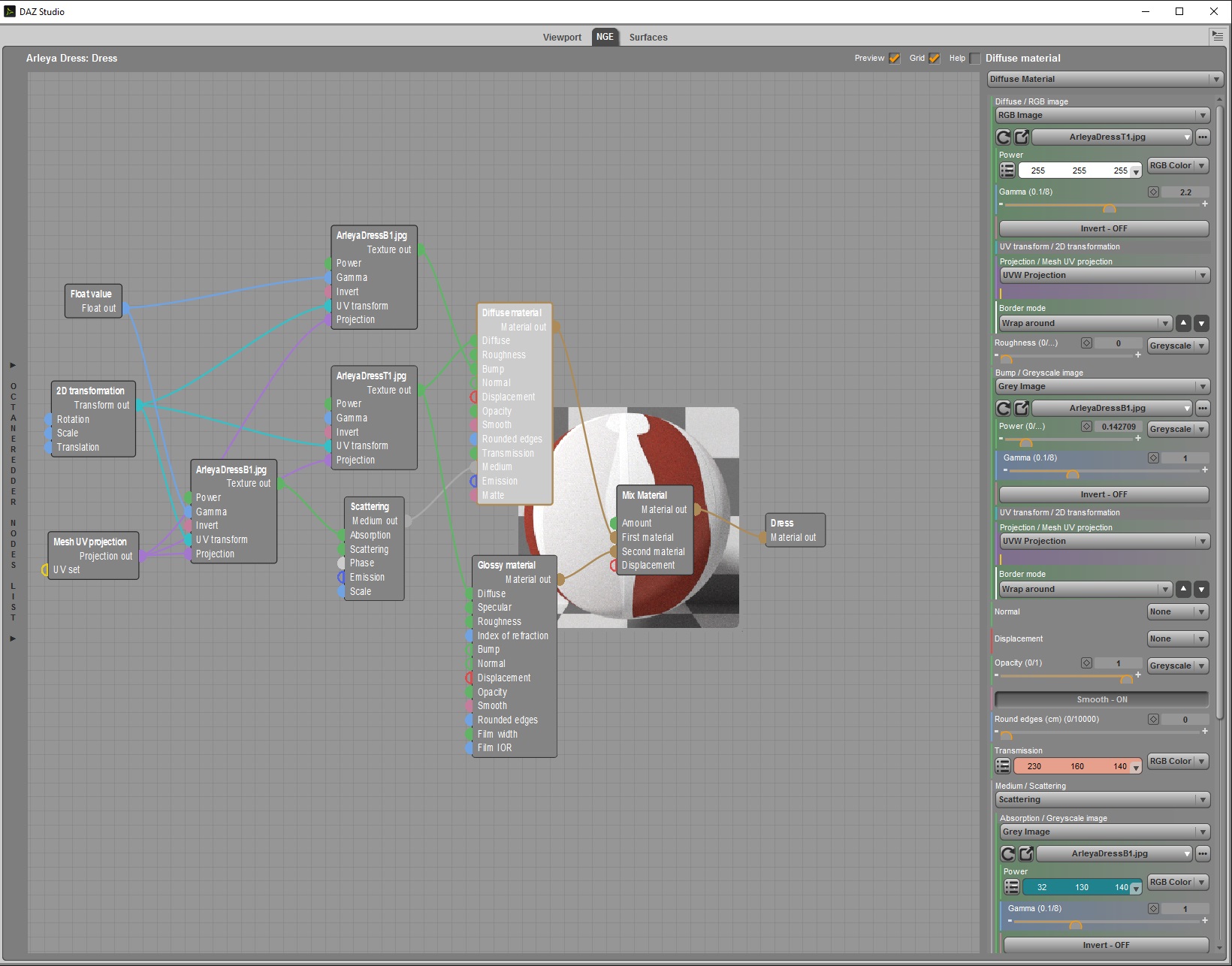

Hi Paul,
I have tested over 80 dresses and all except 2 worked properly. So the issue probably is largely resolved at least for me. I can confirm the below mentioned dress (ArleyaDress) is still causing issue. I tested it for a third time. I am adding screenshots for all the DAZ materials associated with it for you to figure out what is causing the Mix Material node creation for it.

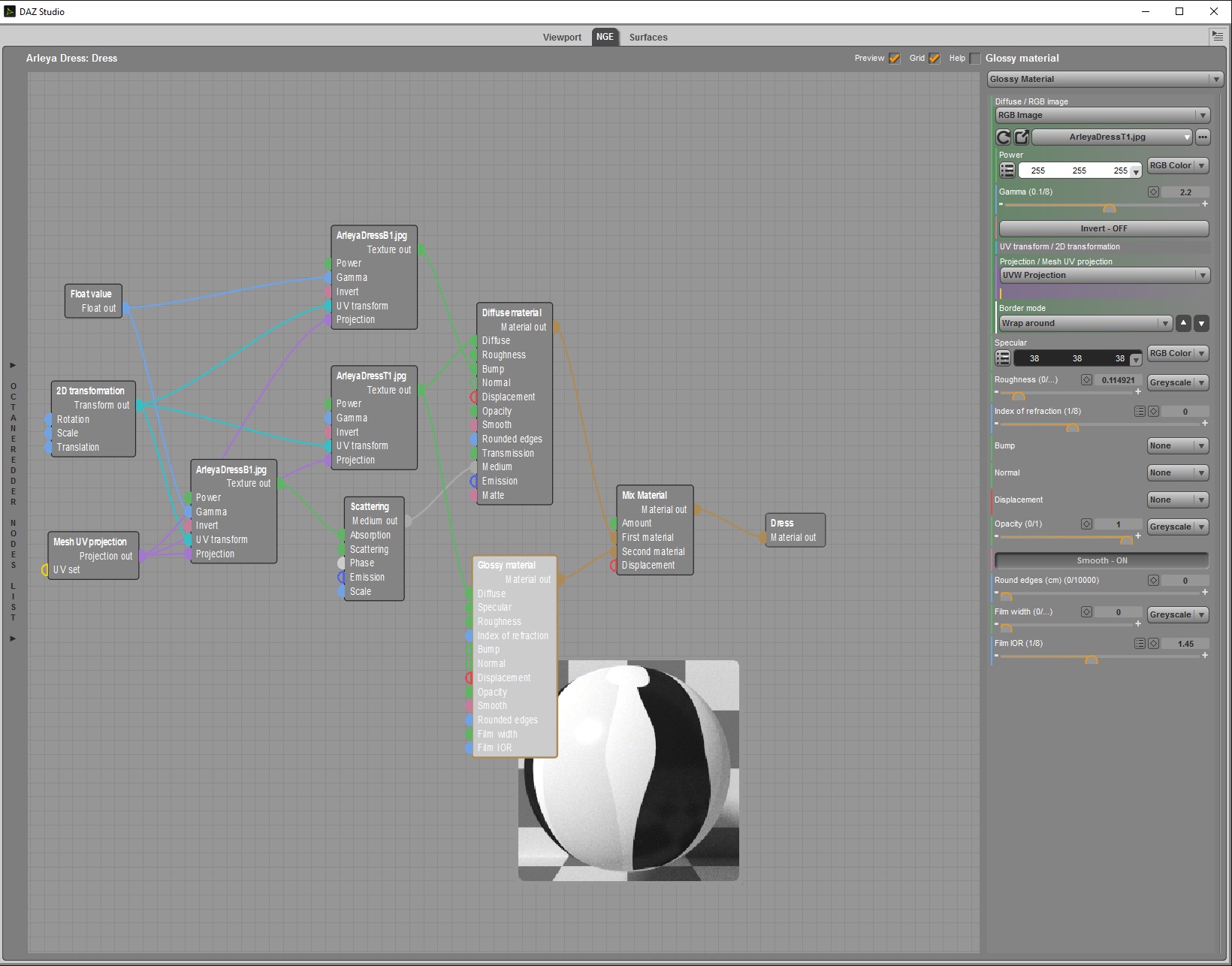

NGE Nodes :
2nd Material - Glossy (Looks ok - Bump map missing )
1st Material - Diffuse (Not sure why this was created - The Medium in this changes the dress color)
Original issue
Best regards,
Rajib

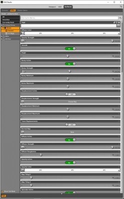

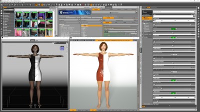

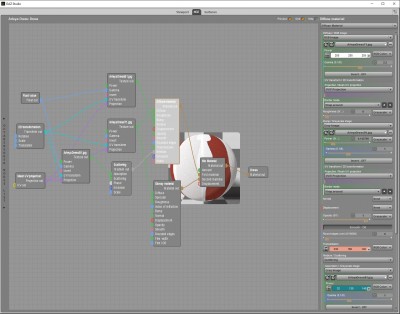

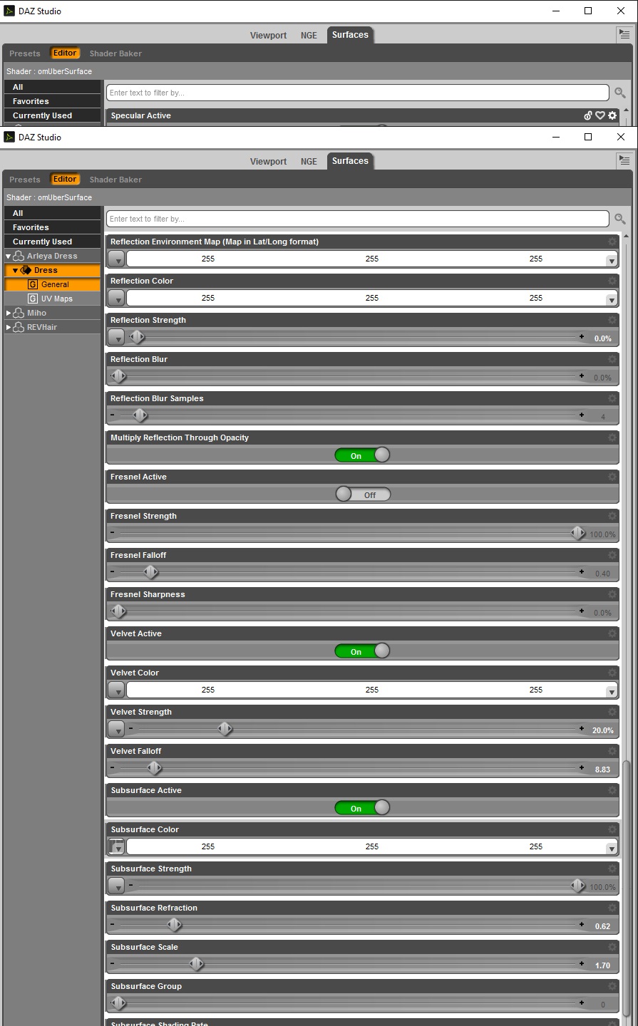

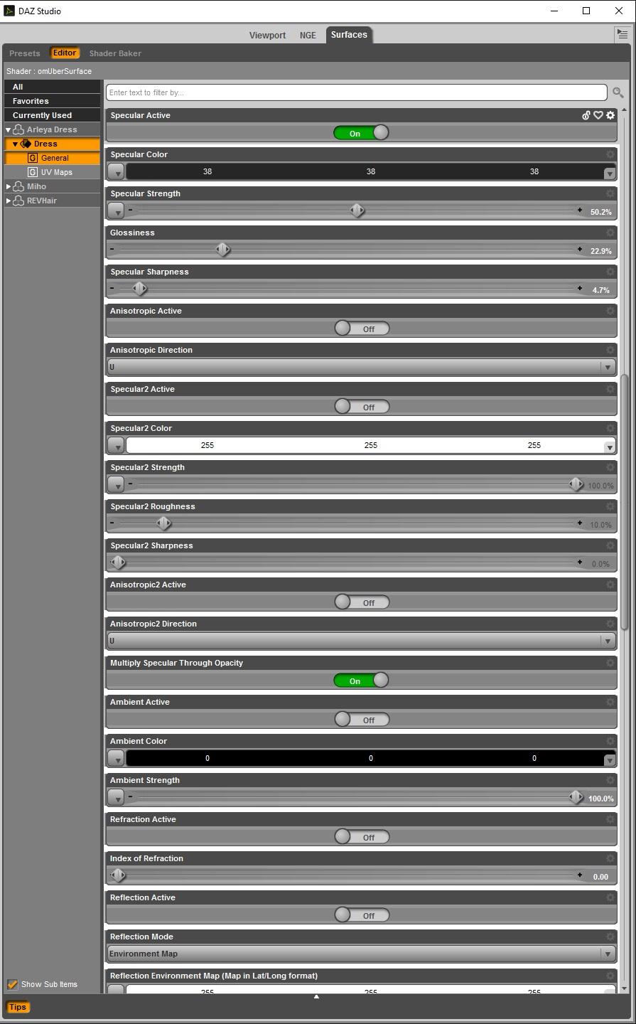

Hi Paul,
The second issue is still there. The dress is getting unexpected color.
The attachment ArleyaDress-ColorChange.jpg is no longer available

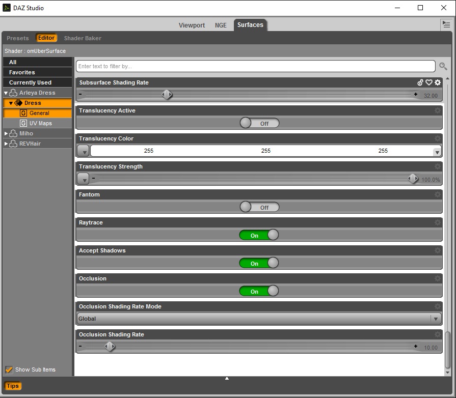

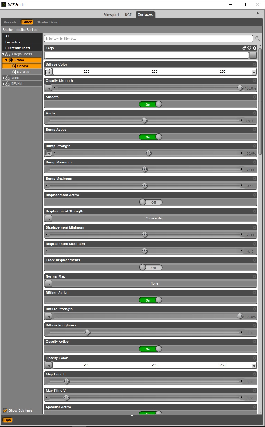

Details of the DAZ material and NGE.
The attachment ArleyaDress-ColorChangeDetails.jpg is no longer available
Not sure why the Medium node was automatically added with those colors changing the color of the dress.
Maybe the issue is that Octane is still doing a Mix Material node for this dress and the first node has the Medium set. The second Glossy node has the correct Diffuse Color and map. So again it may be the issue of Mix material nodes getting created when there should be only a Diffuse/Glossy node being created.
Best regards,
Rajib

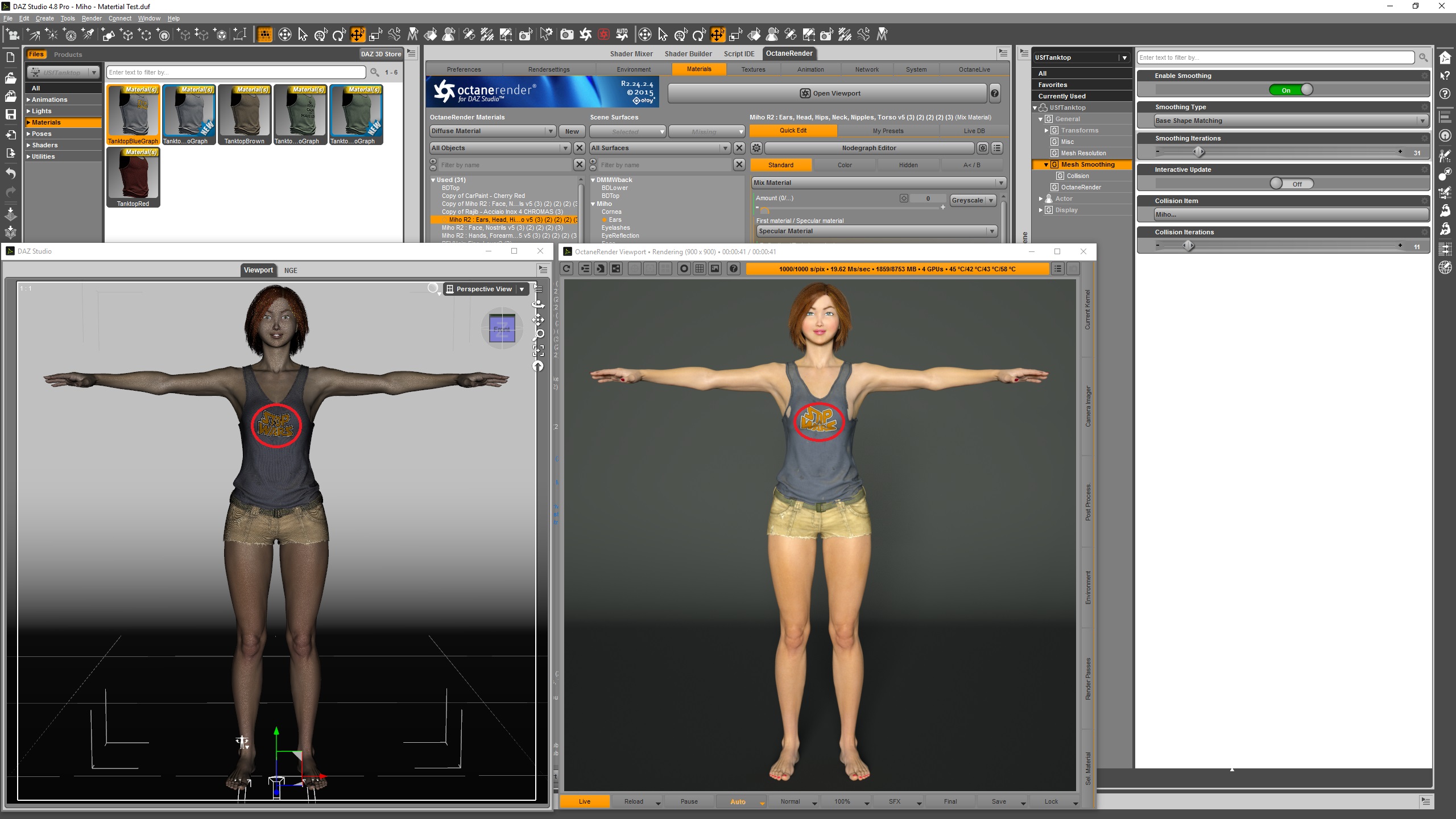

Another problem to report. I am testing with 2.24.2.4. This is related to OR Viewport not updating when there is a change in DAZ.
It is related to the Mess Smoothing. As you know based on smoothing iterations, it can take some time to update the mesh. Generally any Mess Smoothing one applies does update in OR Viewport most of the time. But there is a consistent way I am able to reproduce this issue where the OR Viewport will not update after the mesh smoothing has completed.
Steps to reproduce the issue:
1. Load the G2F character.
2. Load a dress that is tight (easier to see the Mesh Smoothing effect).
3. Apply the Mesh Smoothing. Use a high value like 15 to 30 to see more of the effect of it. (If the Mesh Smoothing is not there for the dress you are using, add it using Edit->Object->Geometry->Apply Smoothing Modifier).
In the Octane Viewport the update should apply once the mesh smoothing has completed.
Mesh Smoothing applied to OR Viewport - OK
4. Now, turn off the visibility of the Dress in DAZ Scene .
5. Change the Mesh Smoothing iteration count a bit. Say whatever value you had chosen before + 1.
6. Turn the Dress visibility back on, OR Viewport will start rendering again and so will the apply Mesh Smoother in DAZ.
You will see the DAZ Viewport will update but the Octane Viewport will not. This issue seems to happen only after the visibility is turned off, mesh smoothing iteration count is changed and then the visibility is turned back on on an object that has the Mesh Smoothing applied.
Issue - OR Viewport did not update.

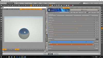

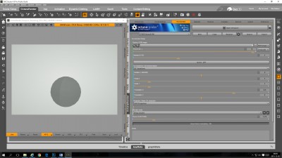

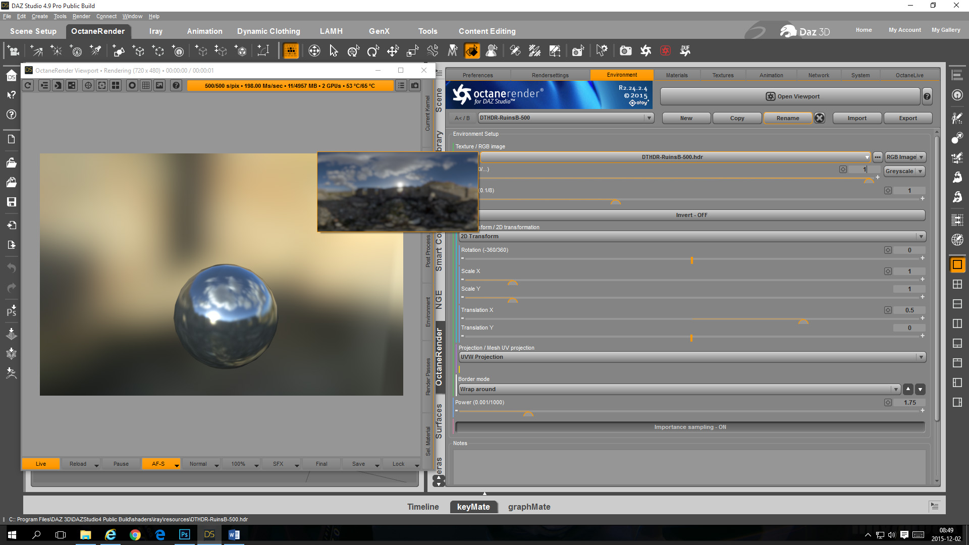

When saving a scene and loading it again
- the HDR environment preset that was active when saving the scene is not selected
- the texture used in the HDR environment preset is missing after manually reloading the preset
Workflow to test
In DAZ Studio
- create new scene
- place a sphere
In the OcDS Material Tab
- use live DB preset chromed steel on sphere
In the OcDS Environment tab
- select default HDR environment preset
- change RGB color to RGB image
- in the texture load option browse to C:\Program Files\DAZ 3D\DAZStudio4 Public Build\shaders\iray\resources
- select DTHDR-RuinsB-500.hdr
- set Gamma to 1
- set Translation X to 0.5
- Rename environment preset to "DTHDR-RuinsB-500"
In DAZ Studio
- save the scene as "HDR environment - load test"
- clear the scene by selecting /file/new
- load scene "HDR environment - load test"
Now you can observe the issues:

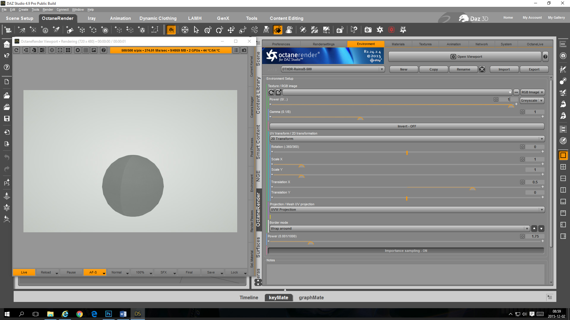

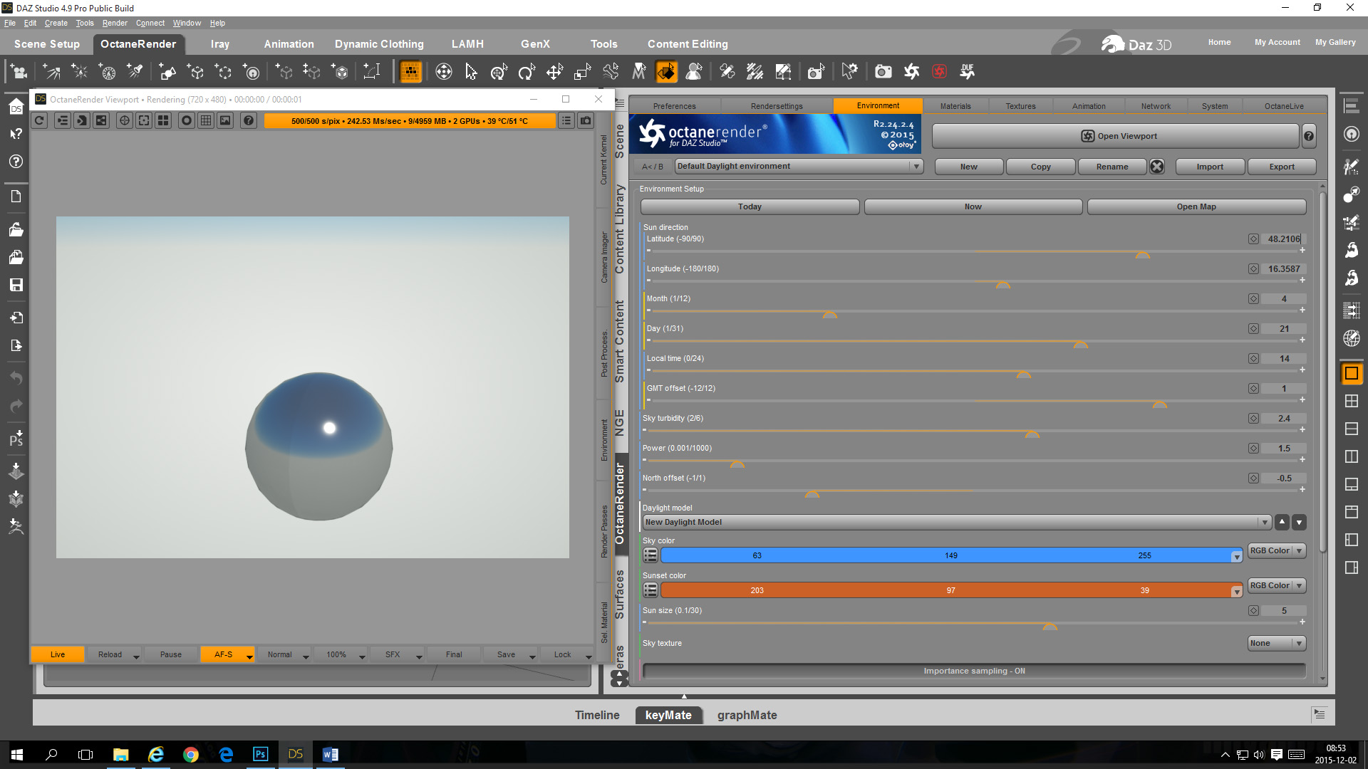

- Issue I: the HDR environment preset that was active when saving the scene is not selected
- select the "DTHDR-RuinsB-500" preset manually from the pull down list
- Issue II: the texture that was supposed to be saved with the preset "DTHDR-RuinsB-500" is missing
003 load scene - Issue II - the texture is not anymore applied to the preset.jpg
The other manually adjusted values seem to be kept.
How it used to work before:
After you loaded a scene all the OctaneRender tabs were in exactly the same state as when the scene was saved.
Textures used in HDR environment presets were remembered.
attached scene "HDR environment - load test.duf" as .zip
HDR environment - load test.zip
(31.04 KiB) Downloaded 270 times
