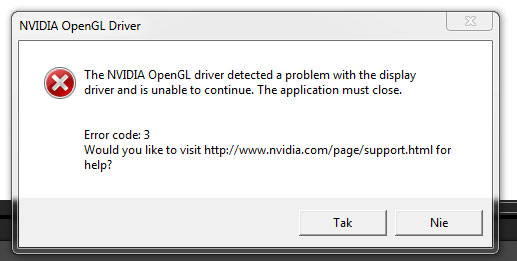

What can be a reason for the error? - see the attachment.

Windows response time. It will give the GPU 2 second by default to respond if not it will reset the driver. Do you have a dedicated GPU for the display? If not then that's the reason. GPU is busy with rendering and doesn't chat with good old win anymore.

Thanks! I have plenty of gpus :) Now I set one for the display :)
