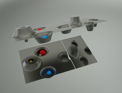

Some thought about the displacement....
I was able to get negative displacement using 32-bit hdr or tiff file created in photoshop..
Rendered below image is done in 3ds max v2.11.1a.
But I must say it's too hard to deal with that displacement image. Ihad to go back and forth between PS and max just to make this silly image.
As for the 32bit image it currently clamps the image at above some +/-stops which is not compressible.
Some brightness values over some point completely clamps the displacement.
Displacement shift option isn't handy at all.
I mean you have to implement a luminance center based kind of approach to solve this..
So that we can easily produce good results assuming that grey gives "0" displacement. white + and black -
This would be really great.
I can share the orbx file exported from max. Currently it's 52MBs please PM me if you find this silly scene would help you.:)

Sorry, is this without using the Shift parameter?

gordonrobb wrote:Sorry, is this without using the Shift parameter?
This is with shift. (I guess it's called "offset" in standalone)
In this example Displacement amount is 1.0 and the shift is -0.5.
So mainly I use it to pull back the displaced mesh to it's original level by using half value of the disp. amount. That being said. image has to be a 32bit image.

As far as I can see when u use 8bit or 16bit images. Black is the lowest value, but it doesnt mean it's the negative value. Black causes no displacement. White is the highest.
Grey is mid-level. All you have to do is use shift in negative values to keep up the main topology level.
I find it very hard to keep the topology using a displacement texture. Then u have to test and trial the shift parameter with eye. Cause it differs from image to image.
Negative values work only with 32-bit images. Formats like hdrs, exr and tiff.
