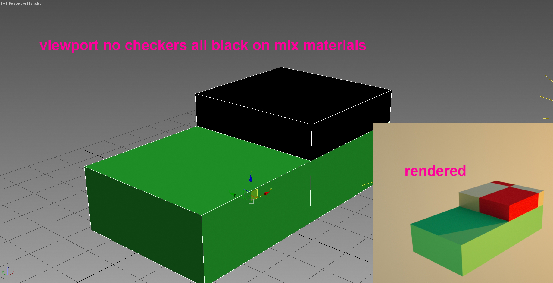

Thank you for your reply I tried everything. I have mix material for top part as checkers and it shows as pure black in viewport but fine when rendered. I attached 2 images. But bottom part shows fine as green because it is jsut a diffuse material and not a mix material. may be 3ds max 2014 glitch. Thank you

Here is a max file maybe someone knows the answer Thank you very much

coilbook wrote:Here is a max file maybe someone knows the answer Thank you very much
OctaneRender materials and texmaps doesn't support "Show Shaded Material in Viewport"
IMHO black color - because Mix material doesn't have proper implementation of "void Mtl::Shade(ShadeContext& sc)" and/or "Color Mtl::GetDiffuse(int mtlNum, BOOL backFace)"
